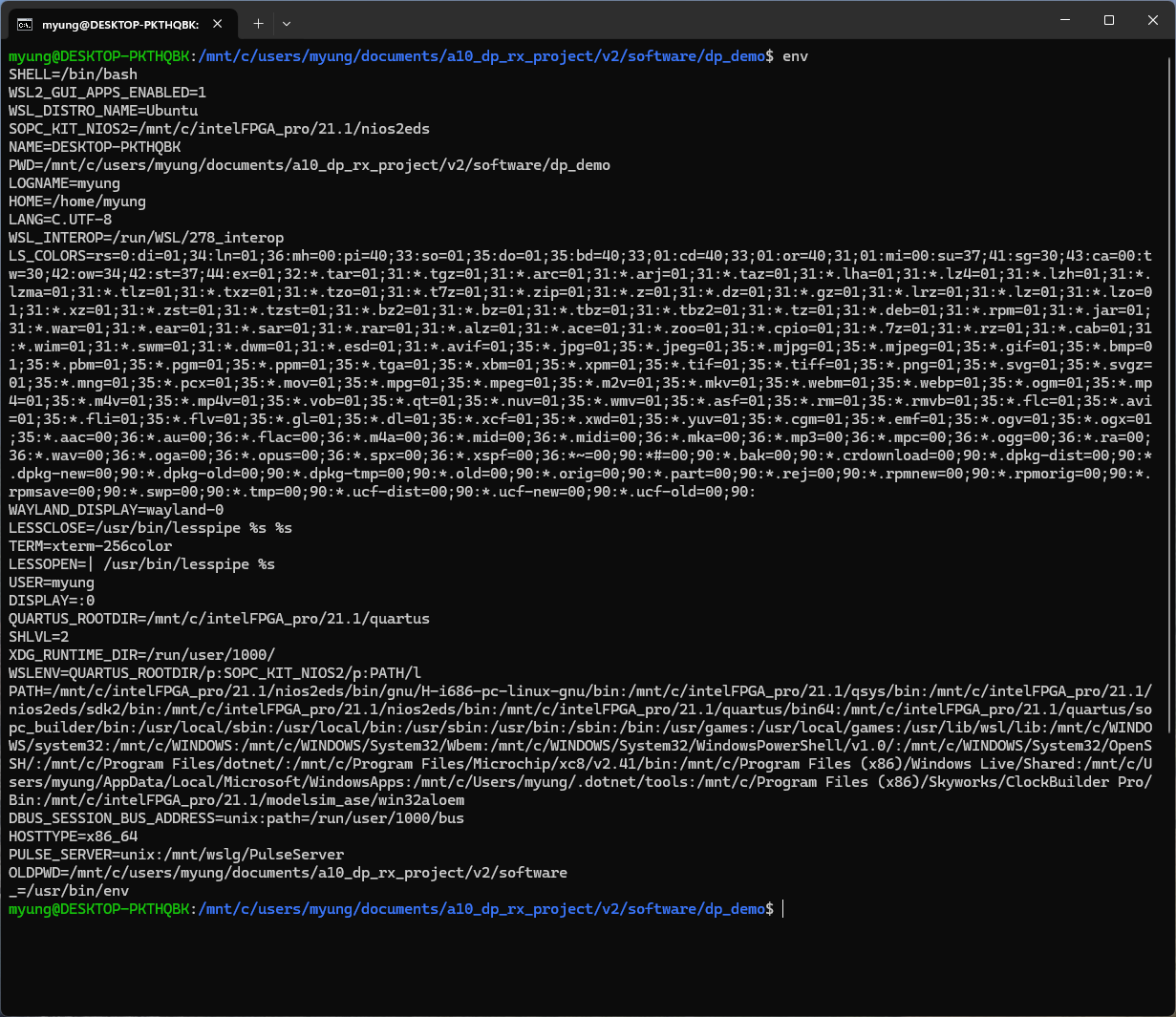

The error message is as follows: "nios2-bsp-update-settings : command not found"
I downloaded the A10_DP_RX_FMC_PRO.par file and compiled it with Quartus Pro 19.2.
AN 900: Intel® Arria 10 DisplayPort 8K RX-only Design
Link: https://www.intel.com/content/www/us/en/docs/programmable/683799/current/compiling-the-design.html
After opening the altera Nios2 Command Shell, I proceeded as in document an900.
When I run source build_sw.sh in the command shell, the following error occurs.
I send you a screenshot of the file directory contents and the execution result.
I have a Quartus Pro license.
I know that nios2 does not require a license. Is this error related to the nios2 licnse?
How to solve this error ?

    Have you confirmed that this is the correct path?
    If you run "ls /mnt/c/intelFPGA_pro/19.2/nios2eds/sdk2/bin" do you see the "nios2-bsp-update-settings" file?

      Yes, there is the "nios2-bsp-update-setting.exe" file
      Even if I run it from where the file is, the same message appears

        Can you please confirm what OS are you using? Are you running this in a WSL command line?

      While running build_sw.sh in the nios2 command shell, the following error occurred:
      make: nios2-elf-gcc.exe: No such file or directory.
      I've attached three screenshots of this issue.
      Please help me resolve this issue.
      Michael
      • Michael2021's avatar
        Michael2021
        The actual directory contains "H-x86_64-mingw32", but the path only contains "H-i686-pc-linux-gnu".
        Is this error related to this issue?
