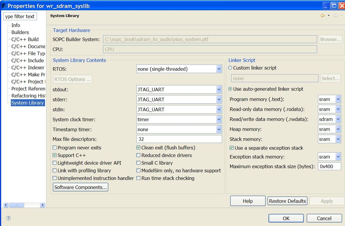

Ok, thanks for the answer, I have the next configuration :
Read/write memory data is SDRAM http://www.pixilis.com/photos/55560/ But the problem is not solve !!!!! When I write for example 10 values the sound is ok, but when I write 1000 the sound is ok for seconds buts after it stops, why ???? If SDRAM doesn't containg program code ( or yes ??) ..... - Altera_Forum
Honored Contributor
I found the solution !!!!!!!!!!! my system has a timer and my C program doesn't have a handler for timer interrupt, If I don't use the timer I have to desactivate it on system properties.
