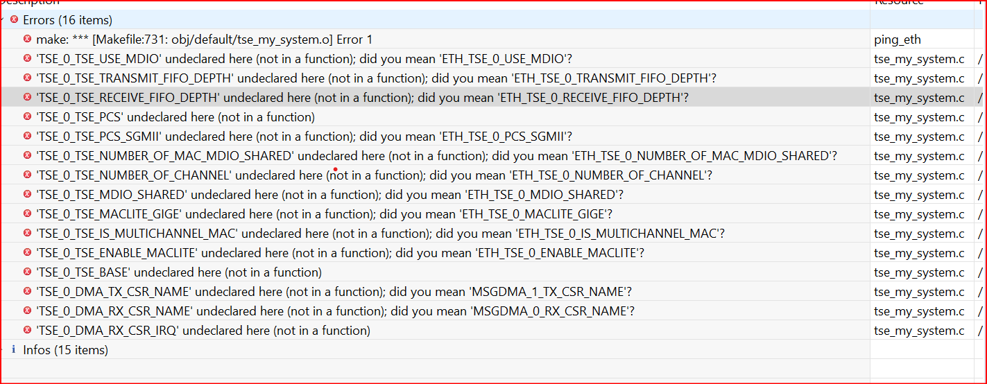

i am working with cyclone 10gx FPGA series, I was trying to create a ethernet MII interface with Nios ii eclipse .i was trying to build one simple socket ping project in Niosii eclipse i am unable to generate .elf in any ethernet simple socket example generation getting errors as shown below .
could you please provide any one have solution resolve the issue ,if any one have faced and resolved.

Hi
I believe we had a call previously arrange by your FAE regarding this issue.

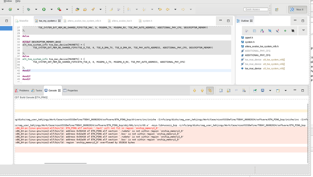

This problem is due to the generated file format was changed in newer Quartus versio.
Could you try to change the line that you are facing error to the line below(line 39, tse_my_system.c) :
TSE_SYSTEM_INT_MEM_NO_SHARED_FIFO(ETH_TSE_0, 0, MSGDMA_1_TX, MSGDMA_0_RX, TSE_PHY_AUTO_ADDRESS, ADDITIONAL_PHY_CFG)

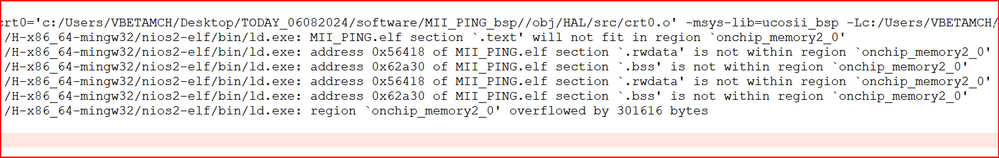

I managed to get it to compile successfully but meet an error in the elf size.

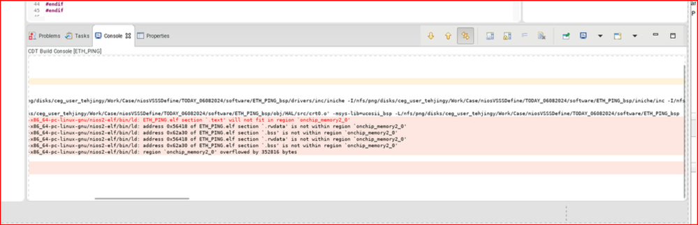

Hi Venkata Sateesh
you could try increasing the on chip memory ip size to accommodate the nios application size.

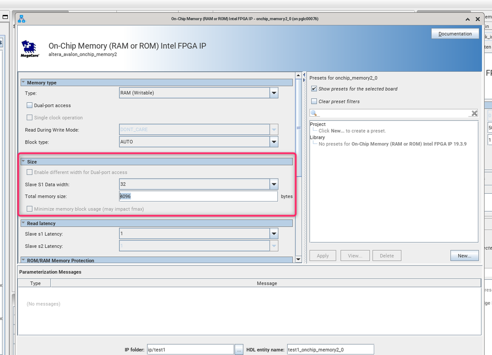

hi Jing yang,
As per the your suggestion i have increased the onchip ram memory but same error is coming .i have tried multiple times. Could you any way to resolve this error,

- tehjingy_Altera
Hi Sateesh
Could you try adding the memory to at least 500KB?
Please make sure that you are increasing the size of the onchip_memory2_0.
You will need to regenerate the project and generate the BSP again before compiling.
Jingyang, Teh
- sateesh999
hi Jingyang,

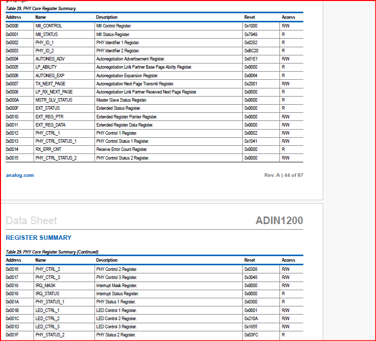

You could find the registers for the values in the datasheet below:
https://my.mouser.com/datasheet/2/609/ADIN1200-3121141.pdf
After going through the datasheet it seems like the registers are not in the standard format below:
* Table below show the format of the return value required by TSE driver PHY detection
* | BIT | Value: Description |
* | 31-17 | Reserved |
* | 16 | 1: Error:Invalid speed read from PHY |
* | 15- 4 | Reserved |
* | 3 | 1: 10 Mbps link |
* | 2 | 1: 100 Mbps link |
* | 1 | 1: 1000 Mbps link |
* | 0 | 1: Full Duplex 0: Half Duplex |
You are required to create your own function to return the speed and and duplex mode.
You can see how it is for the National DP83848C PHY.
The OUI, model and rev from the ADN1200 datasheet is 0x0283, 0x2 and 0x1

- sateesh999
thanks for your support to move forward,
As per your provided input information i have made the changes as i mention below
Step:1
i have create the structure for my phy chip in alter_avalon_tse.c as show below
alt_tse_phy_profile ADIN1200 = {"AD ADIN1200", /* AnalogDevice ADIN1200 */ADIN1200_OUI, /* OUI */ADIN1200_MODEL, /* Vender Model Number */ADIN1200_REV, /* Model Revision Number */0, /* Location of Status Register */0, /* Location of Speed Status */0, /* Location of Duplex Status */0,0, /* Location of Link Status */&ADIN1200_link_status_read /* Function pointer to configure Marvell PHY */};/* add supported PHY to profile */alt_tse_phy_add_profile(&MV88E1111);alt_tse_phy_add_profile(&MV88E1145);alt_tse_phy_add_profile(&DP83865);alt_tse_phy_add_profile(&DP83848C);alt_tse_phy_add_profile(&PEF7071);alt_tse_phy_add_profile(&ADIN1200);step2:i have created function as per datasheet details as shown belowalt_u32 ADIN1200_link_status_read(np_tse_mac *pmac) {
alt_u32 link_status = 0;
alt_u32 reg_status = IORD(&pmac->mdio2.reg1a, 0);/* If speed == 100 Mbps */
if(reg_status & 0x0100) {
link_status |= 0x4;
/* Else speed = 100 Mbps */
else {
link_status |= 0x8;
}/* If duplex == Full */
if(reg_status & 0x0080) {
link_status |= 0x1;
}return link_status;
}step 3:i have add a structure for reg mapping in altera_eth_tse_regs.h as mentioned above with my phy chip
i hope i have done all modification done properly to my make my phy to work for ping application. If anything missing or anything need to correct let me known
