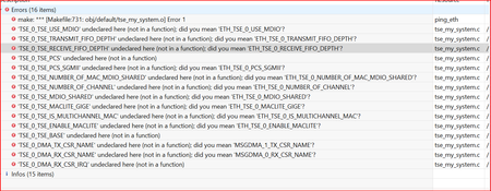

Hi , i am working with cyclone 10gx FPGA series, I was trying to create a ethernet MII interface with Nios ii eclipse .i was trying to build one simple socket ping project in Niosii eclipse i am un...

With the TSE Soft IP, the supported phy includes the following only
National DP83848C (10/100 Mbps)
National DP83865 (10/100/1000 Mbps)
Marvell 88E1111 (10/100/1000 Mbps)
Marvell 88E1145 (Quad PHY, 10/100/1000 Mbps).
However you could add in your own PHY Definition using the API "alt_tse_phy_add_profile()"
