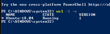

Hi
Could you check the WSL version that you are using currently?
It should be WSL version 1.
"wsl -l -v" To check the version
"wsl --set-version <ubuntu version> 1" to set version.
Jingyang, Teh
- Rainwang
Contributor
hi, Jingyang,
I am very sorry to send response to you so late because I was on vacation in past 2 weeks and can't acess the E-mail.
i just checked my WSL version, it is version 1. please see the attachment and give me more comments.
thank you for the strong support.
Rain
