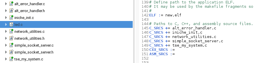

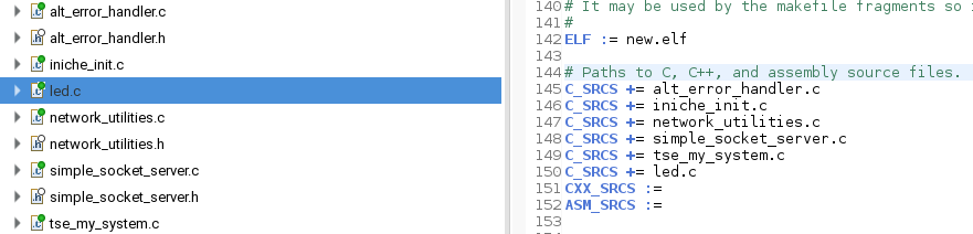

  • Hi,
    I just tested it.
    Remove from Nios II build & Add to Nios II build really works, and the Makefile is updated.
    Apply Remove from Nios II build on led.c
    (Turn to blank circle, and C_SCRS is missing led.c)
    Apply Apply to Nios II build on led.c
    (Turn to green circle, and C_SCRS got led.c)
    Picture attached below.
