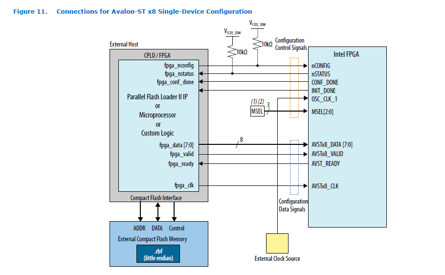

Which banks do you recommend to interface parallel nor flash.
it will be a great help if you tell how many banks do we need to interface parallel nor flash 512Mb .
Thank you in advance.
- NurAida_A_Intel
Hi @hb0001 ,
If I understand correctly, you are referring to below PFL IP. The bank is varies depend on the device's OPN. You need to connect it using dedicated config pins (example shown in Figure below) . For more details , you may checkout this Stratix 10 UG (start from page 40) --> https://www.intel.com/content/dam/www/programmable/us/en/pdfs/literature/hb/stratix-10/ug-s10-config.pdf#page=40&zoom=100,0,0
