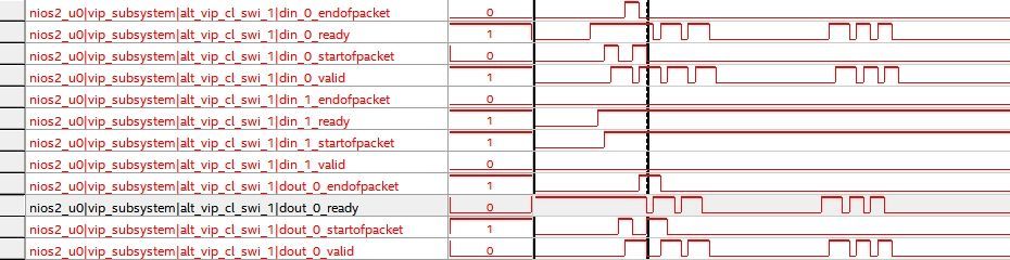

      I think I am looking for why the Switch II IP is not responding to new configuration.
      Below are signals from my project.
      din_0 is PTG
      din_1 is CVI
      dout_0 is frame buffer and will output to CVO.
      After download and before any config, the ready signal raised.
      CVI is Go but without any valid input data.
      And PTG is "Go" at 1080p RGB 10 bit.
      After programming registers to .Dout_0 from din_0 and both inputs as consume mode.
      After config,
      Then I download the nios ii again to do new configuration.
      The Status value of Switch kept at 1.
      I tried using 2 different ways to update the new values but the IP is not responding.

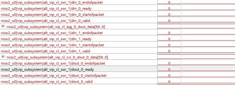

      Here's the configuration and steps,
      1. Set CVO to "GO" and clear underflow.
      2. Set CVI to "GO"
      3. Config PTG as 1080p then "GO"
      4. Config Switch, input source from PTG. din_0 and din_1 as consume mode
      5. Write Switch address 0 to 0, stop the switch.
      6. Keep reading Switch Status till it's 0.
      7. Set Swithc to Go.
      Here's the result,
      Download Nios and repeat above procedures,
      At Step 6, Nios kept reporting Status as 1. And not response to any configuration.
      Captured Signals like below,

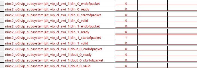

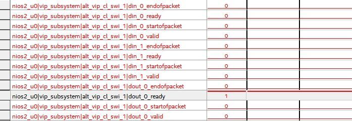

      • JLee25's avatar
        JLee25
        Hi CheePin,
        The new configuration shown similar problem, when I catch signals like below.
        Firmware always returns Status as 1, updating to Switch is not applicable.
        dout_0_ready came from frame buffer, it switched to low when switch is "GO".
        Any comments?
        Regards.
        Johnson
  • CheepinC_altera's avatar
    CheepinC_altera
    Hi Johnson,
    thanks for your update. To further isolate this, can you try to create a simple test design without the frame buffer and external memory. For example, 2 TPGs -> Switch -< CVO. Then try to see if after switching, there is any anomaly with the switch. Thank you.

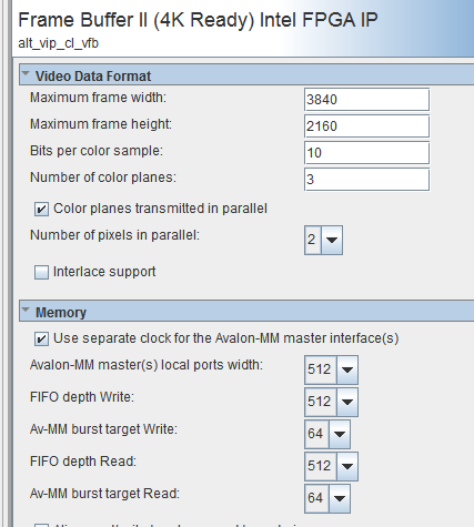

    By the way, just wonder if you observe any issue with the issue with 512 bit width?
    Please let me know if there is any concern. thank you.
    CheepinC_altera
    Hi Johnson,
    Regarding your latest inquiry on the frame buffer width + memory controller for the HDMI example design, as per my discussion with the HDMI and memory folks, they would like to recommend you to open a new case so that they can further look into. Please feel free to let me know the case number after you open it to facilitate the routing.
