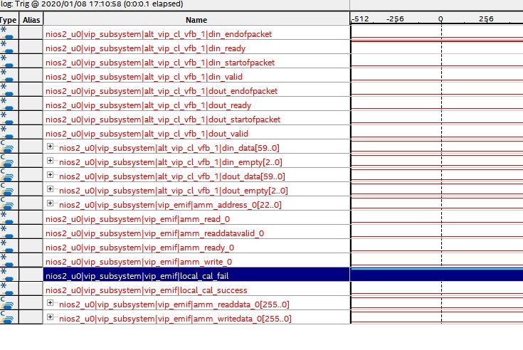

JLee25Contributor to JLee256 years agoHi CheePin, The new configuration shown similar problem, when I catch signals like below.Firmware always returns Status as 1, updating to Switch is not applicable.dout_0_ready came from frame buffer, it switched to low when switch is "GO".Any comments?Regards.JohnsonJLee25Contributor to JLee256 years agoHi Chee Pin, I think the problem is the memory controller.I find the frame buffer ready signal was gone after "GO" for a short period.Then I get the memory signal and noticed that the local_cal_fail raised.This explains why the frame buffer will turn to not ready when switch is "GO".Any suggestion on how could I debug this?Please comment.Thank you!BRs,Johnson
