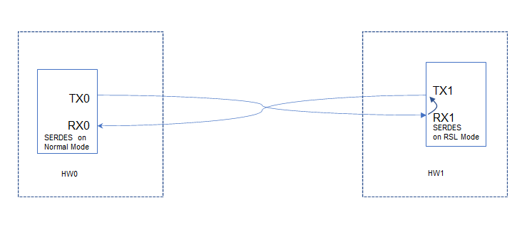

    Consider we have two HW HW0 & HW1
    HW0 SERDES is working on Normal mode
    HW1 SERDES is on RSL Mode
    HW0_TX0 is cable of transmitting the data for some duration and go back to electrical idle for some duration and process will be in loop with different data. Verifying same on HW0_RX0 side
    HW1 SERDES is in RSL, we are expecting the data on HW1_TX1 will be same like HW0_TX0, combination of data and electrical idle
    am i correct?
    Here my query is when our S10 SERDES is RSL mode, if HW1_RX1 is receiving combination of data's and electrical idle, same SERDES HW1_TX1 will transmit same data's and electrical idle or not?
    whenever we are receiving electrical idle on HW1_RX1 , whether HW1 SERDES TX1 will be disabled or do something to reflect electrical idle on tx line?

    Thanks for your update. Please see my responses as following:
    [CP] As I understand it, with the pre-CDR reverse serial loopback, the data received by RX buffer will be loopback to the TX buffer to be transmitted out. When the HW1_RX1 is receiving electrical idle, there will be no data passing to the TX buffer.
    Due to no specific characterization or detail in the user guide, I am not sure what will be the HW1_TX1 output state. You might need to perform a test on hardware to tell. Sorry for the inconvenience.
    Note that the different loopback modes are generally for debugging purpose only. It is not meant for production usage.
