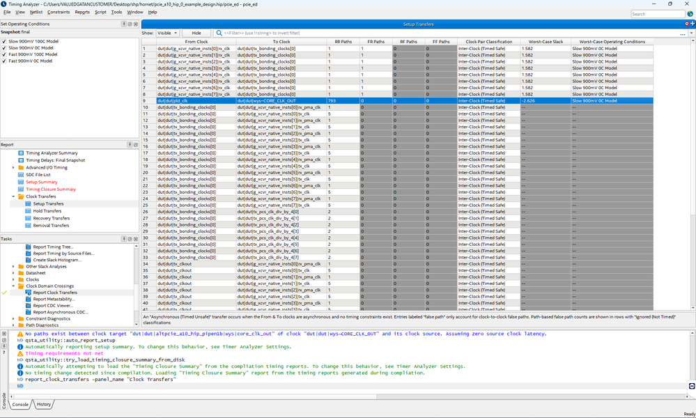

    1. The test_out signals are the pipe interface signals. I need to see what is coming out of the MAC/PCS sublayer.
    2. The test_out to coreclkout is across clock domains. You can see this from the timing analyzer report. Please see the picture.

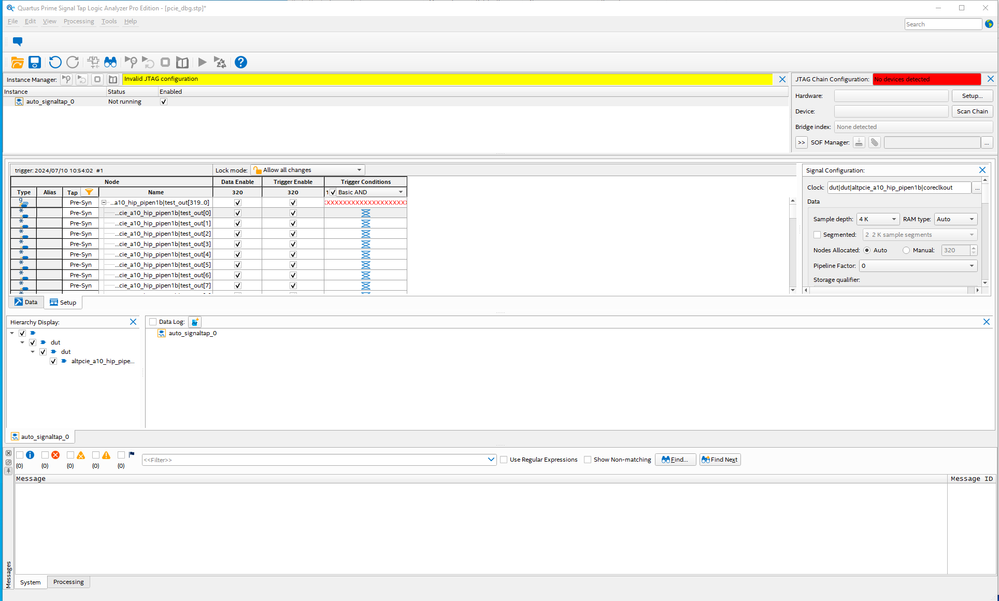

    3. I do not have a picture of signaltap where it complained that the sampling clock was missing. But the screen shot of the signaltap screen is attached.
    4. Yes! LTSSM enters L0 state.
    I have attached the Arria 10 GX dev board example design project with this signal tap. Please check the attached zip file.

        I am unable to trace the .stp file, can you please attach the .stp file separately here ?
        normally for pcie cases, we suggest to use either
        1. dut_coreclkout_hip_clk
        2. dut|dut|altpcie_a10_hip_pipen1b|coreclkout
        3. if not solved maybe you can try out using pld_clk
        Can you please try it and get back to me for your result ?

    According to this timing analyzer report, clocking signaltap with coreclkout will create clock transfers between test_out and signal tap nodes. The test_out is being clocked out by pld_clk. The problem is that signaltap complains that PLD_CLK is not running even after PCIe end point successful enumerates.
    Do we need to write any value on test_in bus to make the pld_clk run? The stp file is called pcie_dbg.stp in the zip file that I attached early on in the post. Let me know if you have trouble accessing it.
