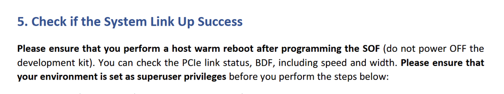

      I still cant find anything that explains what the procedure is when we have a new configuration file that we like to configure the Agilex with without causing a crash or reboot. The document says reboot!!

        What do you means new configuration ? Is it new .sof file to configure the pcie ?
        All PCIe need to go through reboot for re-enumeration process, so reboot is mandatory for the PCIe to link up. (This is based on PCI-SIG specification standard)

    BUT if procedure to configure the PCIe, you may refer to the guide under
    https://community.altera.com/discussions/ip-and-transceiver/how-to-run-pcie-gen-5-design-example-using-altera-fpga-device/125814
    there is a document .pdf who mentioned the full setup that connected to the host.
    That can be a good kickstart for you.
