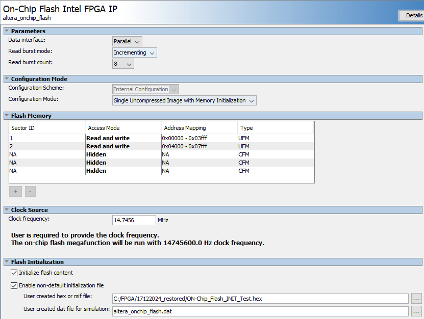

we would like to have an HEX file that will initiate the values inside the Flash
the Flash IP window:

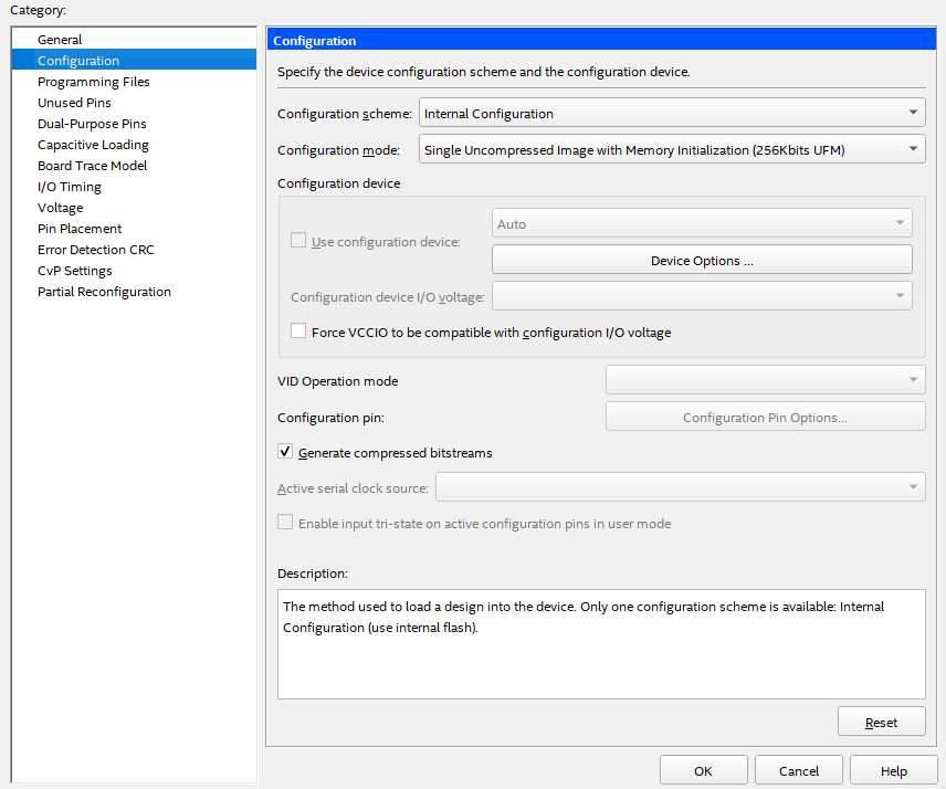

we also set the Device configuration as well to "Single uncompressed Image with MemoryInitialization"
when i complie and program, the data is xFFF...

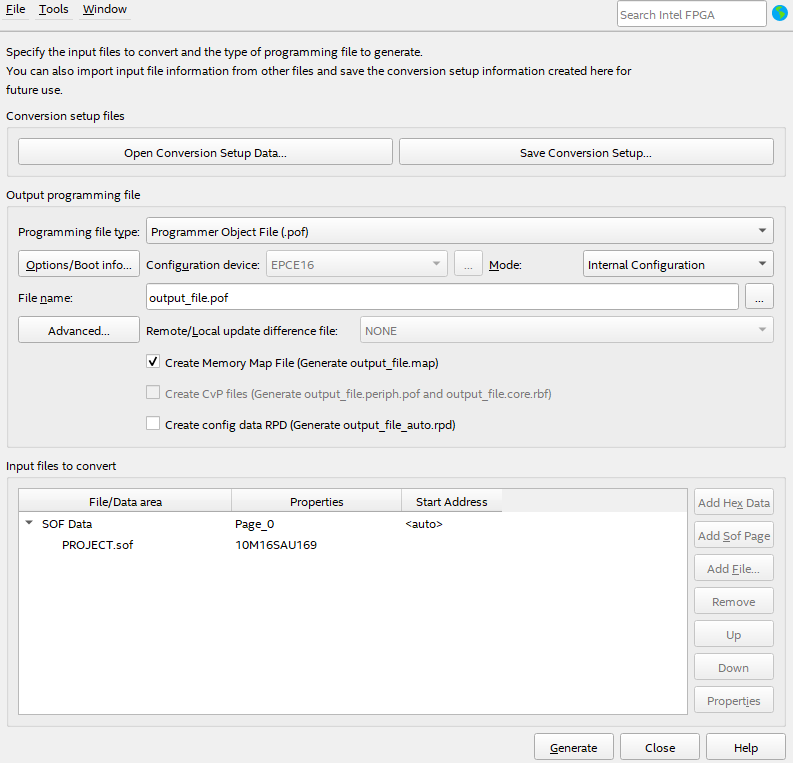

we saw that we need to convert the SOF to POF file

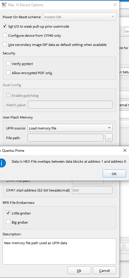

when we try to upload the HEX we get an error:

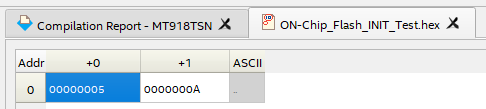

the HEX File needs to be 521 cells with 32bit data
i have notesed that when the HEX is over 1 cell (32 bit)we get this error
for example:

Please check this documentation https://www.intel.com/content/www/us/en/docs/programmable/683180/18-0/flash-initialization-files.html
If the total data size in the initialization file is less the maximum UFM size, the IP core retains blank data (all 1's).
If the total data size in the initialization file is larger than the maximum UFM size, the IP core ignores the extra data.
