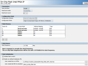

1 year agoimplement On-Chip-Flash with Hex file
Hi All, we are using a MAX10 chip with implemented Flash our target is to have an internal flesh with default values that we will read we have astablished the connection between a component and t...
ShengN_altera
1 year agoHi,
Please check this documentation https://www.intel.com/content/www/us/en/docs/programmable/683180/18-0/flash-initialization-files.html
If the total data size in the initialization file is less the maximum UFM size, the IP core retains blank data (all 1's).
If the total data size in the initialization file is larger than the maximum UFM size, the IP core ignores the extra data.
Sheng
