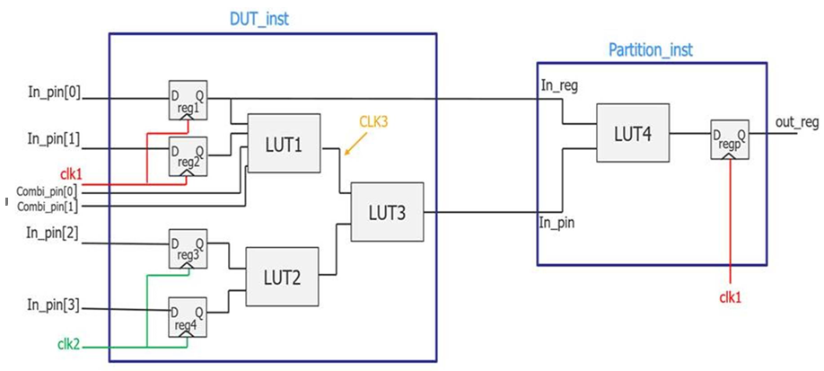

    So for example I created this test case:
    I get the fanins of the "In_pin" input using "-async" , "-sync" and "-clock" option and I get no difference between the 3 results.
    So how can I see the difference between these options in a design?
