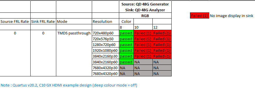

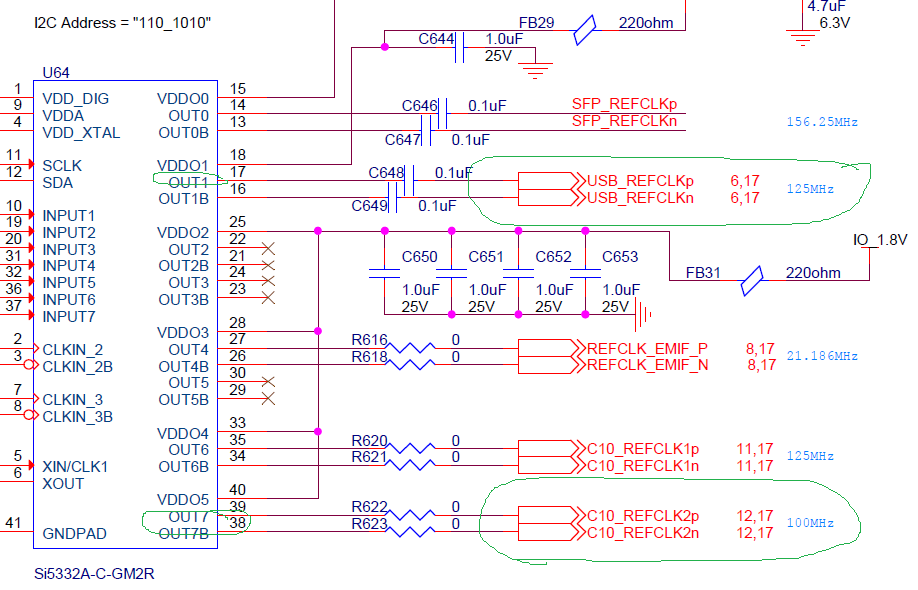

  • Hi Neil,
    We suspect HDMI Rx failure encountered at your site is expected because you removed NIOS II design block which also function to perform CDR refclk switching from CDR refclk0 to CDR refclk1.
    • Your modified HDMI Rx design is now stuck with wrong (CDR refclk0) instead of using correct TMDS clock (CDR refclk1).

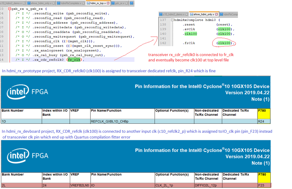

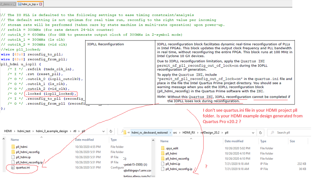

    In short, I believe you can follow below guideline that I drafted
    Guideline for modification to HDMI Rx only design should be like below :
    1. Option A : for customer that required quick XCVR power up calibration
    • Remove everything else but keep (HDMI Rx top, NIOS II design and also the design code with comment "// Workaround for long power-up calibration issue")
    1. Option B : for customer that doesn’t need “quick XCVR power up calibration” requirement
    • Remove everything else including NIOS II design, just keep HDMI Rx top only
      • Modify gxb_rx NativePHY IP to change default CDR refclk to 1 (refer to attached pic)
      • regenerate gxb_rx IP and recompile HDMI design again
