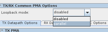

Say I need to connect an oscillating component (with parallel data) to the GTS from the fabric, and then loop it back to via serial in fabric, and then read the output parallel data.
To set this up, can I simply:
1: Set the "TX/RX Common PMA Options Loopback mode" to "parallel"
2: Route `i_rx_serial_data` back to `o_tx_serial_data`
assign gts_i_rx_serial_data = gts_o_tx_serial_data;
assign gts_i_rx_serial_data_n = gts_o_tx_serial_data_n;
3: Connect an oscillating component to the `rx_parallel_data`?
Of course I have omitted many signals here, but is it along the right lines?
Many thanks!
  • Hi,
    Thanks for your update.
    Based on your description, it seems your datapath is structured as follows:
    Oscillator → tx_parallel_data input → GTS PHY → rx_parallel_data output → DMA → HPS
    To achieve this setup, you can enable the Parallel Loopback path (Path B). This configuration allows the parallel data fed into the TX interface to be directly routed to the RX interface, bypassing the serializer, deserializer, and CDR blocks.
    This approach should help simplify your testing or validation process without involving the full high-speed serial path.
    Let me know if you need further clarification or assistance.
    Chee Pin

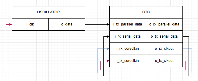

  • CheepinC_altera's avatar
    CheepinC_altera
    I understand you have some inquiries regarding the parallel loopback configuration of the XCVR PHY. To ensure we're aligned, could you kindly elaborate on the specific data flow of your target implementation?
    It would be helpful if you could reference Figure 21: PMA Loopback Modes in the GTS Transceiver PHY User Guide: Agilex 5 FPGAs and SoCs, so we can better understand your intended setup and provide more accurate guidance.
    Looking forward to your clarification.
    • K606's avatar
      K606
      Hi @CheePin_C_Intel
      Yes let me explain a little more.
      My design will be:
      Oscillator -> GTS (loopback) -> DMA -> HPS.
      Where the oscillator produced parallel data, the GTS serialises it and loops it back deserialised, and the DMA fetches data for a user application.
      I really don't have a preference in terms of what loopback mode to use, it could be any of the three - likely I will try them all.
      Many thanks!
