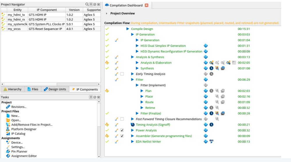

Due to some reasons, this dual simplex configuration is not suitable for my project. I need rx offset = 0,
like in the picture:
I save this config, regenerate HSSI Dual simplex IP, reassign pin locations for rx, so they occupy channels 0 - 2. All the rest assignments stay unchanged.
In that case the fitter is not able to succeed.
Then I've removed all pin assignments to allow the fitter to find the right place by itself. But it still is not able to fit.
At the other hand, the Quartus 24.2 was able to do this. But when I take pin assignments from q24 (which were successfulluy fit) and give them to q25, it is still not happy.
Has someone any ideas, how to fit my configuration?

    Thank you, WIncent.
    Unfortunately, your project has the same problem. Fitter-Plan is not able to find a legal placement.
    I use q25.1.0 build 129, patch 0.36

    • Wincent_Altera's avatar
      Wincent_Altera
      Hi AlehTS​ ,
      Is weird, because I can get it pass 100 %
      I am using "QUARTUS_VERSION "25.1.0 SP0.36 Pro Edition"
      Wincent

  • Aleh_TS's avatar
    Aleh_TS
    Hi Wincent.
    My .v code is correct. Analysis and Synthesis pass well. The problem is in fitter.
    Anyway, can you send me the whole your project (.qar), please.
    Thank you.
    Wincent_Altera
    Hi Aleh_TS
    I have attached the updated top.v file.
    1) sda and scl signal is not connected at top.v
    2) syspll_clk is mistakenly connected to syspll_lock signal.
    Please try to adding the  sda and scl signal in top.v and removing the connection between syspll_clk  and syspll_lock
    With the update i able to get the compilation passing. Can you please try it out ?
    Else I would suggest you to continue with v24.2 which is working well - it save your effort.
