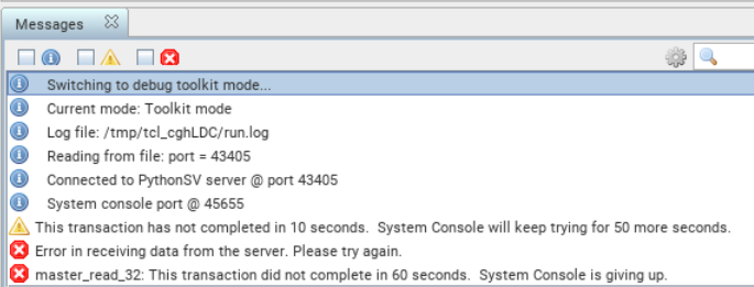

This is an issue sharing of Agilex P-tile MCDMA PCIe Debug Toolkit :
Agilex® 7 P-tile Multi Channel DMA Intel® FPGA IP for PCI Express Debug Toolkit isn't working for Gen4 1x8 in Quartus® v22.4. However the P-Tile MCDMA DTK is working fine in Gen4 1x16.
Gen4 1x8: Not able to open Toolkit as it throws a timeout error.
This problem is planned to be fixed in future release of Quartus® Pro software version.
