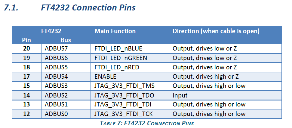

Onboard_USB3_Instructions_11Dec24.pdf document pinout for FT4232 Connection, some pins are not matching with AGILEX™ 5 FPGA E-SERIES 065B MODULAR DEVELOPMENT KIT - SOM schematic. Please let me know which one we need to fallow. Example ENABLE Pin.
And
LED Connections i can fallow as per below table ? is there any proven reference with LEDs ?

I got info that the schematic that you refer was designed before the USB3 specification in place. The upcoming production version of this development kit should follow the USB3 specification.
So, to answer your question, you can follow the USB3 specs.
