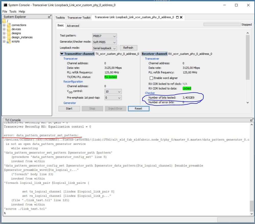

Wiki contains a standard example design "cv_GX_1ch_40b_3125mbps" that can be used to test the Transceiver Toolkit. The Toolkit GUI works as awaited: can open the link and make the tests (see blue marked results):
So far so good ....
An example contains also a TCL-script (link_test.tcl) for the scripting API based testing. But this script fails to open the data_pattern_generator service (see red market error message). The open_service doesn't report any errors but any access to the settings of the data_pattern_generator FAILS.
% open_service data_pattern_generator "/devices/5CSEBA6(.|ES)|5CSEMA6|..@1#USB-1#TDSUB2/(link)/JTAG/alt_sld_fab_sldfabric.node_0/phy_0/master_0.master/data_pattern_generator_0.csr_slave/driver"
% data_pattern_generator_is_generating  "/devices/5CSEBA6(.|ES)|5CSEMA6|..@1#USB-1#TDSUB2/(link)/JTAG/alt_sld_fab_sldfabric.node_0/phy_0/master_0.master/data_pattern_generator_0.csr_slave/driver"
error: data_pattern_generator_is_generating: /devices/5CSEBA6(.|ES)|5CSEMA6|..@1#USB-1#TDSUB2/(link)/JTAG/alt_sld_fab_sldfabric.node_0/phy_0/master_0.master/data_pattern_generator_0.csr_slave/driver is not an open data_pattern_generator service
    while executing
"data_pattern_generator_is_generating  "/devices/5CSEBA6(.|ES)|5CSEMA6|..@1#USB-1#TDSUB2/(link)/JTAG/alt_sld_fab_sldfabric.node_0/phy_0/master_0.master..."
