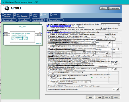

1 month agoThe entire ALTPLL configuration interface is glitching. Anyone know how to fix this?
Hi, does anyone know what's going on with this configuration interface and how to fix it? I am using Quartus Prime 25.1 Std and the 10M02SCM153C8G chip, and I'm trying to use the ALTPLL IP core. ...

Thank you FvM for the answer.
Yes, this is a known issue, and a patch is available to address it. Please refer to the KDB article for details on obtaining and installing the patch.
https://community.altera.com/kb/knowledge-base/why-does-the-text-overlap-in-the-altpll-ip-parameter-editor/349903

1 month agoHi Martin,
known bug, see ALT PLL GUI MESSDED UP ON INVOCATION | Altera Community - 337656
Need to install a Patch for 25.1 Std.
