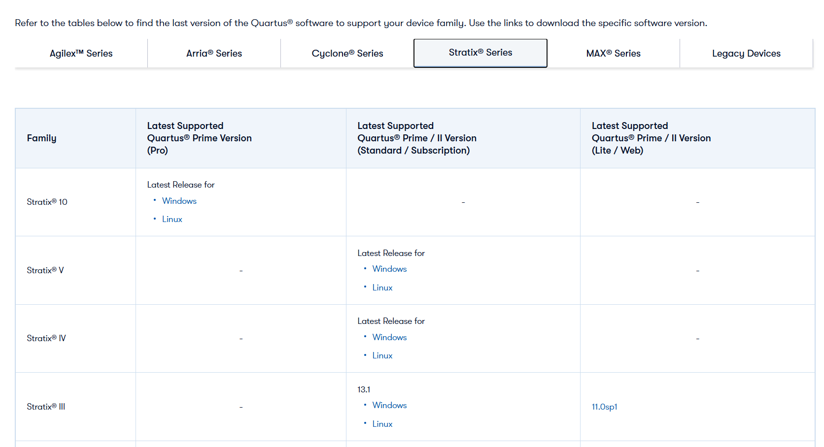

Thank you for the details. The license you generated through the SSLC — "Discontinued – Quartus® II Software (License: SW-QUARTUS-WE-FIX)" — is a Web Edition license. The "WE" in the license name stands for "Web Edition".
To use the Stratix III Development Kit, you may consider the following options:
1. Purchase a Quartus II Subscription Edition license
Quartus II Subscription Edition licenses include support for Stratix III devices and will contain the required stratixiii feature line that enables the device family in Quartus.
2. Use a Quartus II Web Edition version that supports Stratix III
Based on the device support information from https://www.altera.com/design/guidance/software/device-support, Stratix III devices are available in Quartus II Web Edition 11.0 SP1. The SW-QUARTUS-WE-FIX license generated through the SSLC can be used with this Web Edition release.Please refer to the attached screenshot from the device support page for reference.
I hope this helps clarify the licensing behavior you are seeing.
When you have a chance, could you please try the suggested option and let me know how it goes?
If you have any additional questions or run into any issues, please feel free to reach out. Thank you.
