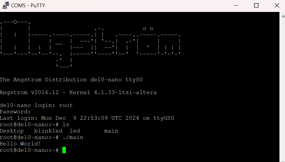

      And I think the de10 nano image is properly written to sd card, since I get the angstorm boot image when I open my puTTY session (as shown below).
      So about my setup, the de10 nano is connected to
      1. power source
      2. RJ45 cable to an ethernet router port
      3. UART to USB port cable to the USB of my PC.
      And my PC is connected to
      4. RJ45 cable to another port of the same ethernet router.
      Is my setup right? There is a different ethernet IP address assigned to my de10 nano eth0, and a different IP address for the ethernet connected to my PC.
