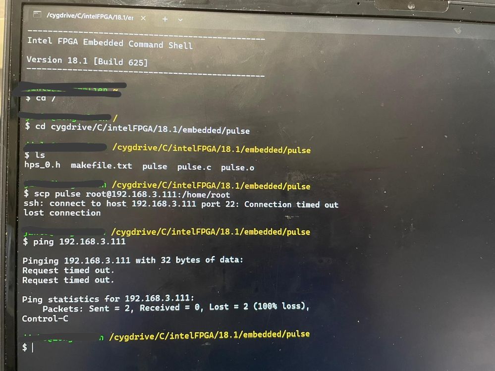

I tried the ssh command shown in the screenshot, and it says connection timed out.
<ssh -vvvv 192.168.3.136>

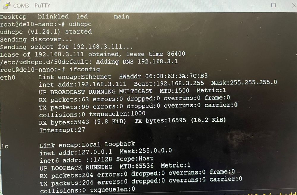

And I think the de10 nano image is properly written to sd card, since I get the angstorm boot image when I open my puTTY session (as shown below).

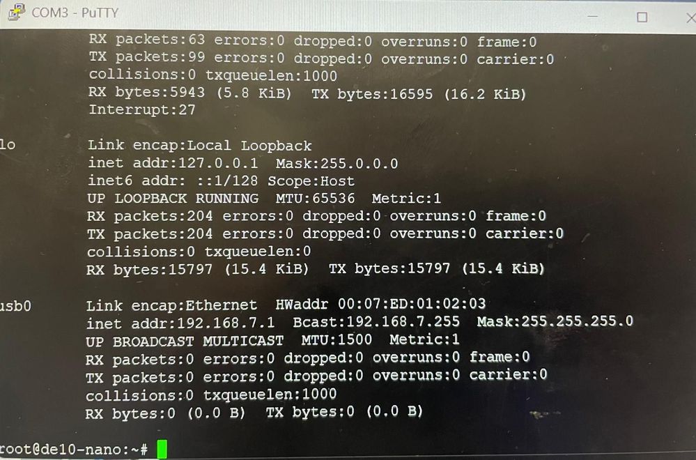

The "ifconfig" of puTTy is shown here. The IP address of de10 nano is <192.168.3.111>

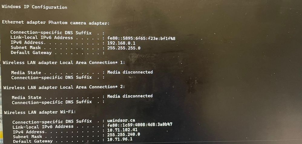

The "ipconfig" of my PC command shell is shown here. The IP address of the ethernet connected to the PC is <192.168.0.1>.

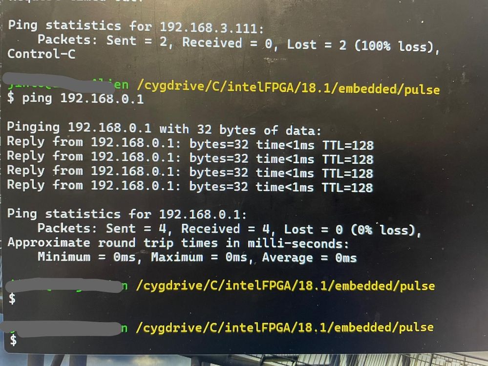

Trying to ping the de10 nano's IP address from the Embedded command shell. As you can see, it says "Request timed out". Unable to "scp" the file.
Tried pinging the IP address of my PC from my PC Embedded command shell, and it works.

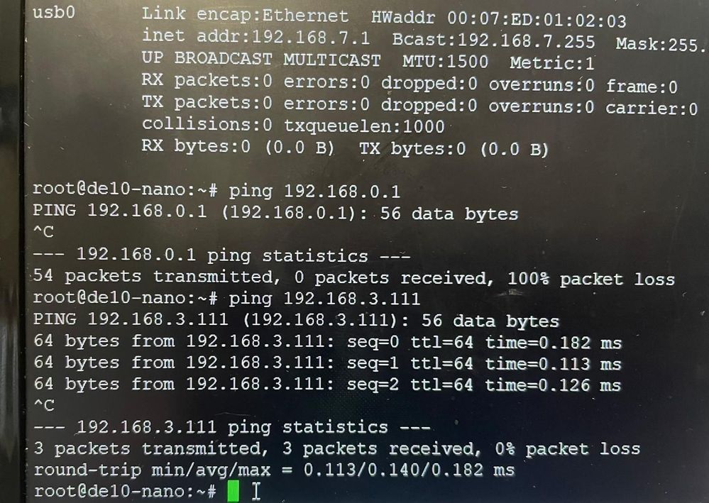

Trying to ping the IP address of my PC from puTTY. As you can see 100% packet loss.
Tried to ping the IP address of my de10 nano from puTTY, and it works.
