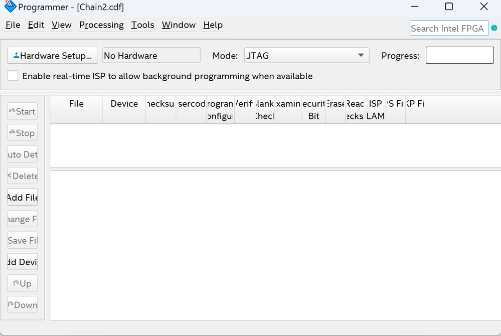

    Hello!. I'm currently trying to use Quartus 22.1.2 on Windows 11 ARM. The driver you supplied worked well and device manager recognizes the USB Blaster. However, the hardware setup in Quartus Programmer fails to recognize the board. Does anyone have any idea how I could solve that? I already tried the newest Quartus version and the issue remains.

    I checked that the USB blaster is displayed in the device manager, the drivers are installed, and the event log indicates that the device is working. But there is no USB blaster in the Quartus hardware setup. Could the reason be that I bought the blaster on Aliexpress?
    • mcmaster_ece's avatar
      mcmaster_ece
      This seems like a software incompatibility. Which version of Quartus are you using? I've only tested this with 22.1, but 19.1 through 23.3 appear to share the same x64 DLL files.

      Thank you, I was able to install the driver, but the Quartus does not see the USB Blaster. How to solve this problem?
      • Ceniza's avatar
        Ceniza
        You need to select it in Hardware Setup…
        If it still doesn’t show up, then double check in Device Manager that the USB Blaster is detected and not missing a driver.
        I can only confirm that it worked with a de10-nano by following the steps in the guide to test their first FPGA example.
