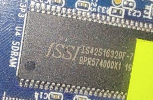

I'm using Quartus 20.1 lite and a DE10-lite board that uses a 10M50DAF484C7G FPGA and a issi 45S16320d sdram.

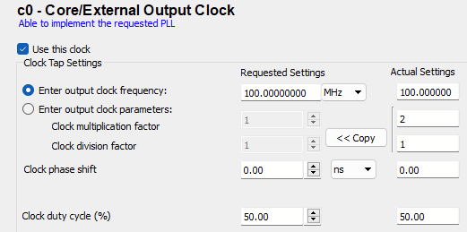

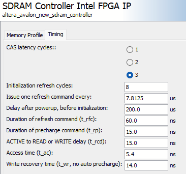

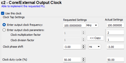

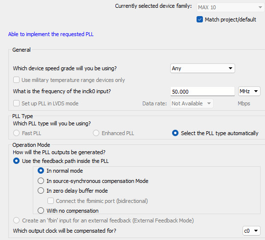

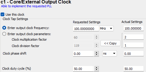

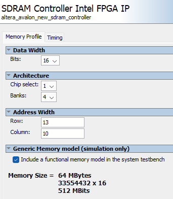

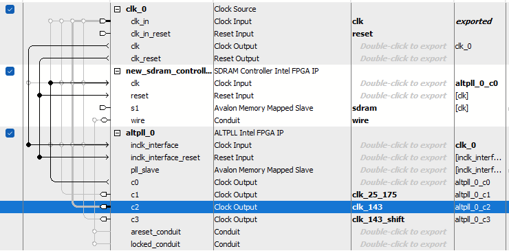

qsys config:
PLL config:
SDRAM Controller IP config:
qsys output

    That's the SDRAM mounted on the board:
    And that's the doc I used (it's the online version of the pdf attached to the CD): https://www.issi.com/WW/pdf/42-45R-S_86400D-16320D-32160D.pdf
    While writing this I realized that on the photo there is an 'F' as last character visible not a 'D' as in the CD docs. I couldn't spot any difference timing wise, but to be sure that's the one with an 'F':
    https://www.issi.com/WW/pdf/42-45R-S_86400F-16320F.pdf
