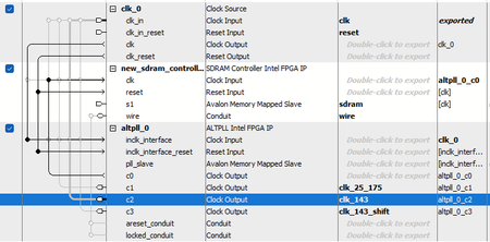

Hello! I'm writing a simple RAM and VGA testing module. At first data gets written to the SDRAM (repeatedly 0 to 4095) and then it's read from the sdram and written to a FIFO to show it as p...

Hello Adzim,
that's true! The problem is that the readvalid signal should go down if the next value isn't ready yet and that doesn't seem to happen.
Although I found another solution using a completely different controller, I would be interested in the cause of the issue.
The settings of the IP are so simple, I would consider it as foolproof. If there is any chance that this is not an issue caused by me but some "bug" in the IP it may be interesting to investigate it.
