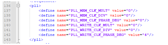

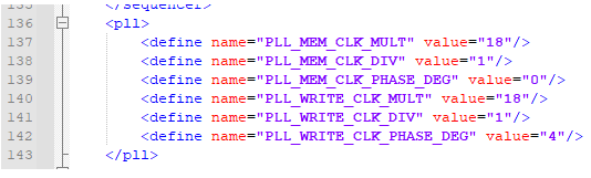

Am working on a project with CYCLONE V - 5CSXFC6D6F31C8N with Quartus 18.1. After compilation in emif.xml file in the hand off folder the SDRAM related clock info is being written as 0 by quartus. The preloader doesn't work therefore.
We had to manually set the value to make it work. But not sure this is the best value. Please suggest appropriate values for these.

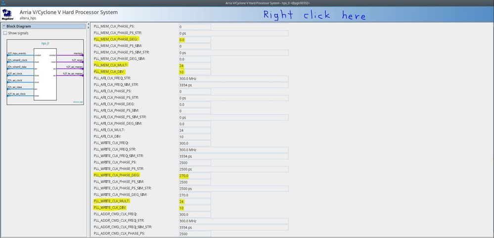

I noticed the quartus version after 18.1 is using the default values as below:
You can try to work with those default values.
These values are found in the hidden parameters in of the HPS IP. You can try right click on the blue gradient in the UI pic above to display the hidden parameters. The parameters in the emif.xml is auto generated based on these settings.

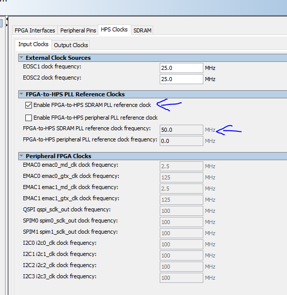

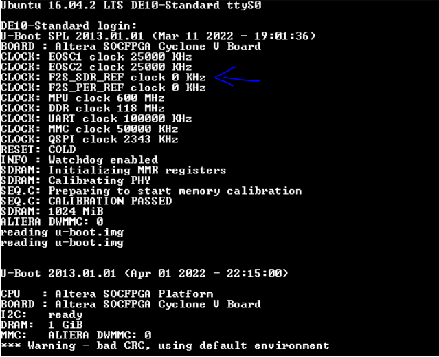

There is definitively a problem with the preloader generation. I set the clock for the DDR3 from the FPGA at 50Mhz. But the preloader bootloader shows 0.

Below is the image, refer to the default values of the IP:You can try to check the hidden parameters of the IP in platform designer to verify again the difference before and after generate.
The hidden parameters can be displayed when right click on the blue gradient part of the pic above.

Does the specic values for DDR clock 118MHz relected in the emif.xml file?

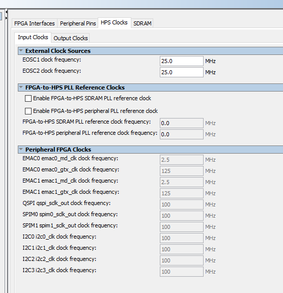

I see that your F2S_SDR_REF clock is 0 KHz even you have set to 50Mhz, I think is because the bridge was not enabled yet.
When in u-boot, you can run the cmd "bridge enabled" and if possible check any changes to the F2S related clock values.

Thanks for the response. 118MHz is not reflected in the emif.xml file.

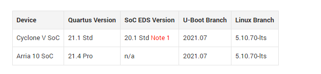

Are you booting up with QSPI or sdcard? The logs which I normally see when boot up is like the example logs in the document below:

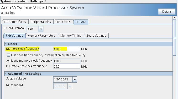

Other than that, may I know under the SDRAM->PHY Settings of the Cyclone V HPS IP settings, what is the Memory clock frequency{MEM_CLK_FREQ} that you set?
Aik Eu
- syam
Hi Aik
We are working with Quartus 18.1. The rocket board link you shared is for the latest Quartus 21.1. For 18.1 the appropriate link would be this - https://rocketboards.org/foswiki/Documentation/EmbeddedLinuxBeginnerSGuide
The preloader boot log automatically gets printed via the serial interface on power up and it comes from the preloader software.
We are booting from the SD Card.
SDRAM->PHY Settings of the Cyclone V HPS is shown below.

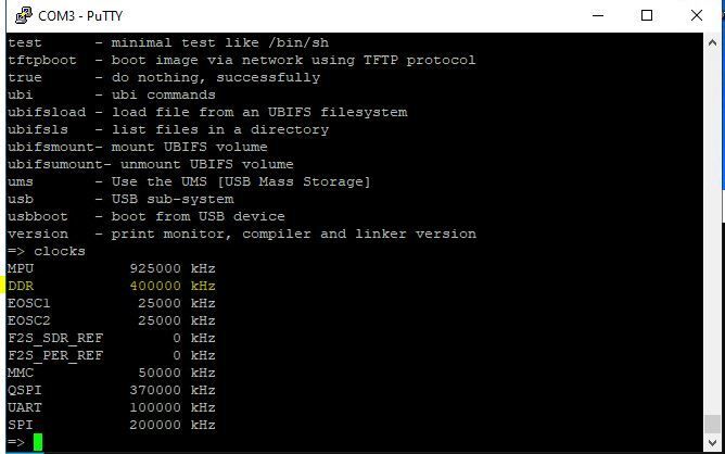

In U-boot, type help.
Check if there is command bridge and clocks in the help list?
If there is command bridge, type bridge enabled.
Type clocks to show the available clock infos.
Compare the clock infos with those infos shown during the preloader boot up.
Can re-try the above steps without bridge enabled as well to notice any difference.

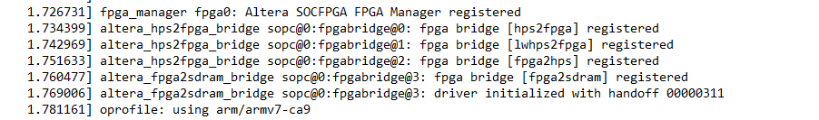

Here is the bootlog attached. The bridges seems to be registered.
Note that we are able to boot in to Linux. But we are unable to use the 50Mhz from FPGA to run the SDRAM.

We don't have the clocks command in our version of u-boot (shipped with Quartus 18.1). We have only these commands in our version.

Looks like the old u-boot dont have that clocks command and that 2013 version of U-boot is too old to be supported.
I suggest you git clone the newer U-boot version for your project build.

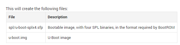

Also in Quartus 18.1 with SOC EDS we are were generating the following - preloader-mkpimage.bin and u-boot.img.
If you see the instructions you shared the preloader binary is in different format so it is not going to work in the Quartus 18.1 boot flow. Please help.
