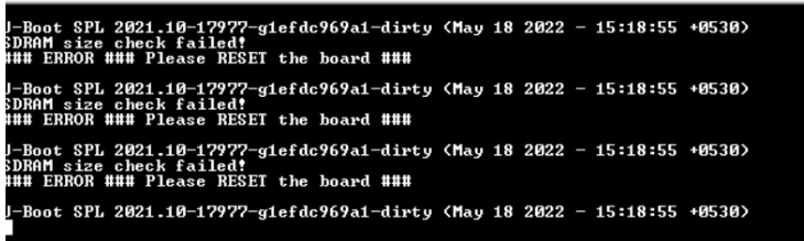

Migrated my FPGA design to Quartus 20.1.1, compiled and generated the RBF and tested with old 18.1 boot flow. The RBF is working.
Then I followed the latest boot flow you suggested. Generated the files required. Now right at power up and boot up I am seeing this error.
I found this article - https://www.intel.ca/content/www/ca/en/support/programmable/articles/000073948.html which points to a similar error. There it is suggested that a bug exist with uboot source code. Also a patch is given. But it seems it is related to Arria10 and not Cyclone V which am working with. But I tried applying it but it didn't get applied. May be because it is intended for Arria10 only.
Any help would be much appreciated.
