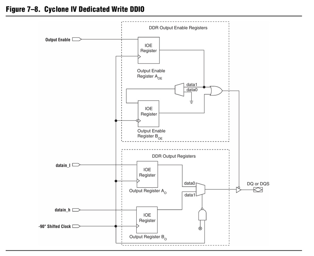

**1. Figure 7-8: Cyclone IV Dedicated Write DDIO**
In Figure 7-8 (page 7-14), the clock input to the DDIO registers is labeled **"-90° Shifted Clock"**, while the output is labeled **"DQ or DQS"**.
This appears to imply that the same phase-shifted clock arrangement applies to both DQ and DQS output paths.

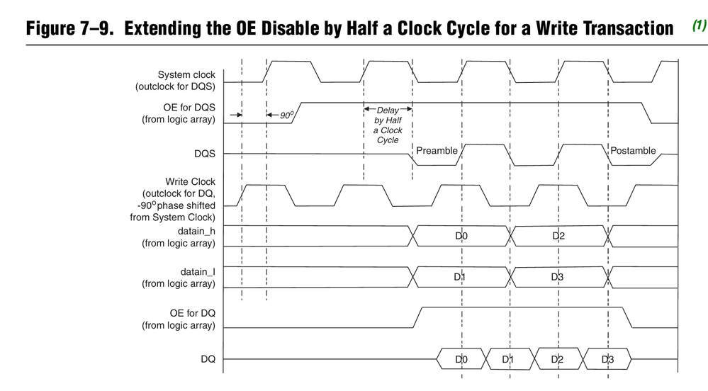

**2. Figure 7-9: Extending the OE Disable by Half a Clock Cycle for a Write Transaction**
However, Figure 7-9 (page 7-15) explicitly identifies two different output clocks:
- System Clock: outclock for DQS
- Write Clock: outclock for DQ, shifted by -90° relative to the System Clock
Furthermore, the PLL section on page 7-15 states that the system clock generates the DQS write signals, while the -90° shifted write clock generates the DQ signals during write operations.

1. Is Figure 7-8 intended to represent a generic DDIO structure, with the "-90° Shifted Clock" label applying specifically to the DQ path?
2. For the DQS output path, are its DDIO data registers and output-enable registers clocked by the unshifted System Clock, as suggested by Figure 7-9?
3. If so, should the clock label in Figure 7-8 be corrected or clarified to distinguish the DQ and DQS paths?
I would appreciate confirmation of the actual hardware clock connections and whether this is a documentation error.

    What Figure 7-8 actually shows
    Figure 7-8 illustrates the generic DDIO circuit structure — the same IOE hardware block used for both DQ and DQS pins. The single label "-90° Shifted Clock" reflects the typical case shown (the DQ/DM data output path), but the block itself is instantiated separately for each pin with its own clock connection. The "DQ or DQS" output label is simply indicating the block's physical output pin, not implying both use the same clock.
    The actual clock assignments per signal type
    Figure 7-9 gives you the correct, specific picture:
    • DQS (write strobe): clocked by the unshifted System Clock from the PLL
    • DQ and DM (write data): clocked by the Write Clock, which is the PLL output shifted –90° relative to the System Clock

    1. Yes — Figure 7-8 is a generic DDIO hardware diagram. The "-90° Shifted Clock" label applies specifically to the DQ (and DM) data path. The same physical block is used for DQS, but driven by the unshifted system clock.
    2. Yes — For the DQS output path, the DDIO output registers (both data and OE) are clocked by the unshifted System Clock, exactly as Figure 7-9 shows.
    3. This is a documentation labeling ambiguity in Figure 7-8 rather than an error in the silicon. Figure 7-9 is the authoritative representation of the two-clock write architecture. The generic block in Figure 7-8 would benefit from a note clarifying that the clock source differs between the DQ/DM and DQS instantiations of the block.
    In short: your reading of Figure 7-9 is correct — two separate PLL outputs drive DQS and DQ/DM respectively, with the DQ/DM clock being –90° behind the DQS clock to produce center-aligned write data at the memory device.

      My question specifically concerns the accuracy of the clock label in Figure 7-8 of the Cyclone IV Device Handbook (CYIV-5V1-2.2).
      Although the generic DDIO interpretation is plausible, it does not establish whether the "-90° Shifted Clock" label was intentionally used for a diagram representing both DQ and DQS.
      Could an Altera engineer verify the intended clock connections and confirm whether a documentation clarification or erratum is warranted?
