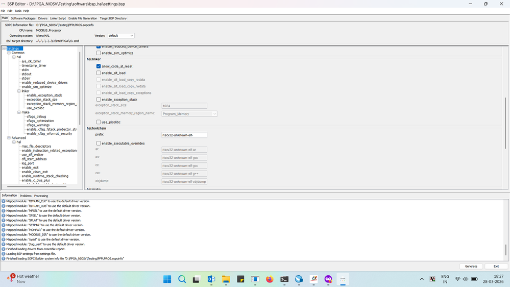

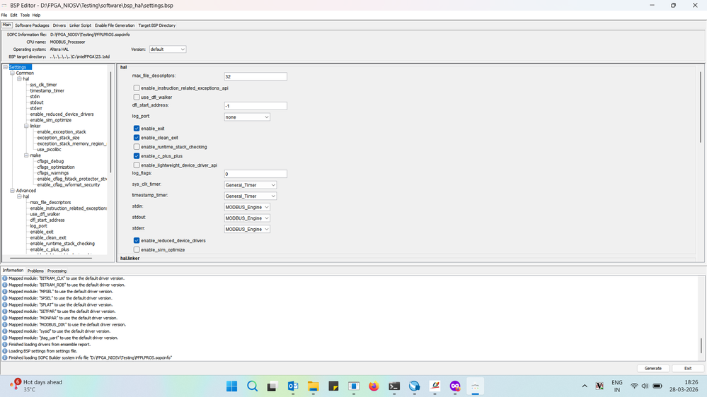

Hello sir , i am also facing same kind of problem. when i am debugging my code , it working fine and i can access the EPCQ64A but when i run the code in standalone mode it, code works but cannot acce...

For the NiosV are you running the NiosV application XIP in the EPCQ64A?
What is the behavior when you try to access the memory inside the flash?
If you are running the NiosV XIP on the flash, you should be able to read from the flash but it is not possible to write to the flash.

Could you describe what error you are facing when trying to access the flash?
Are you able to read any values or write data to flash in NiosV?
I believe you are using the GSFI IP to access the flash am I right?
