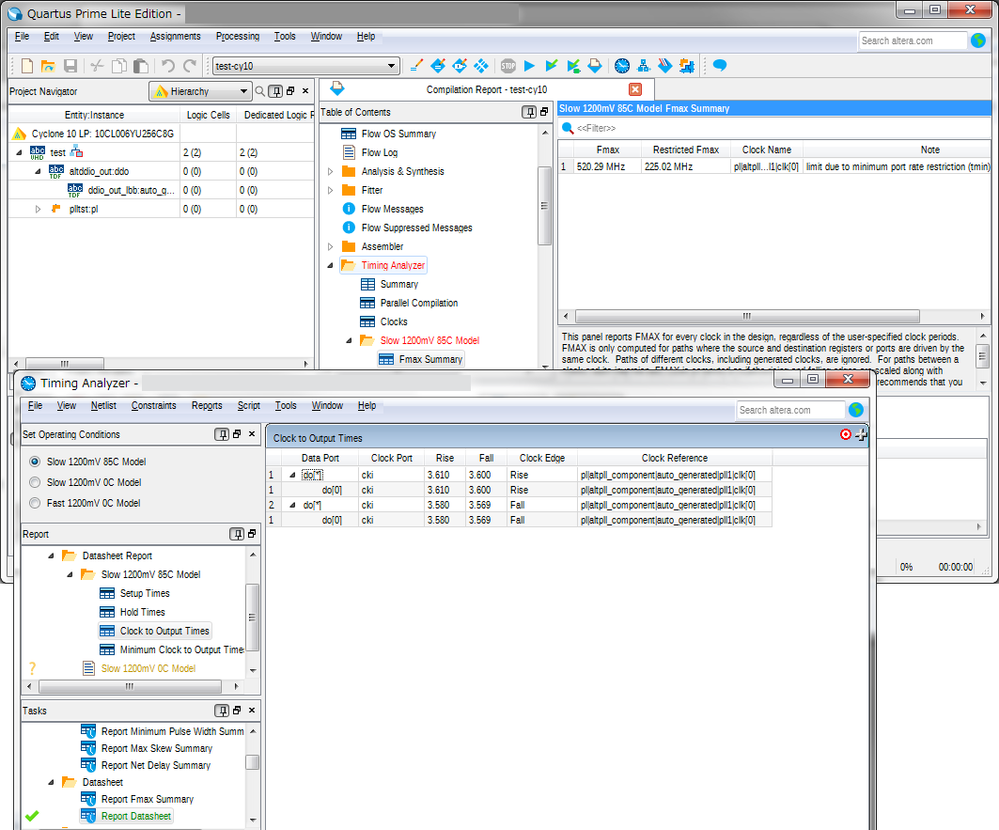

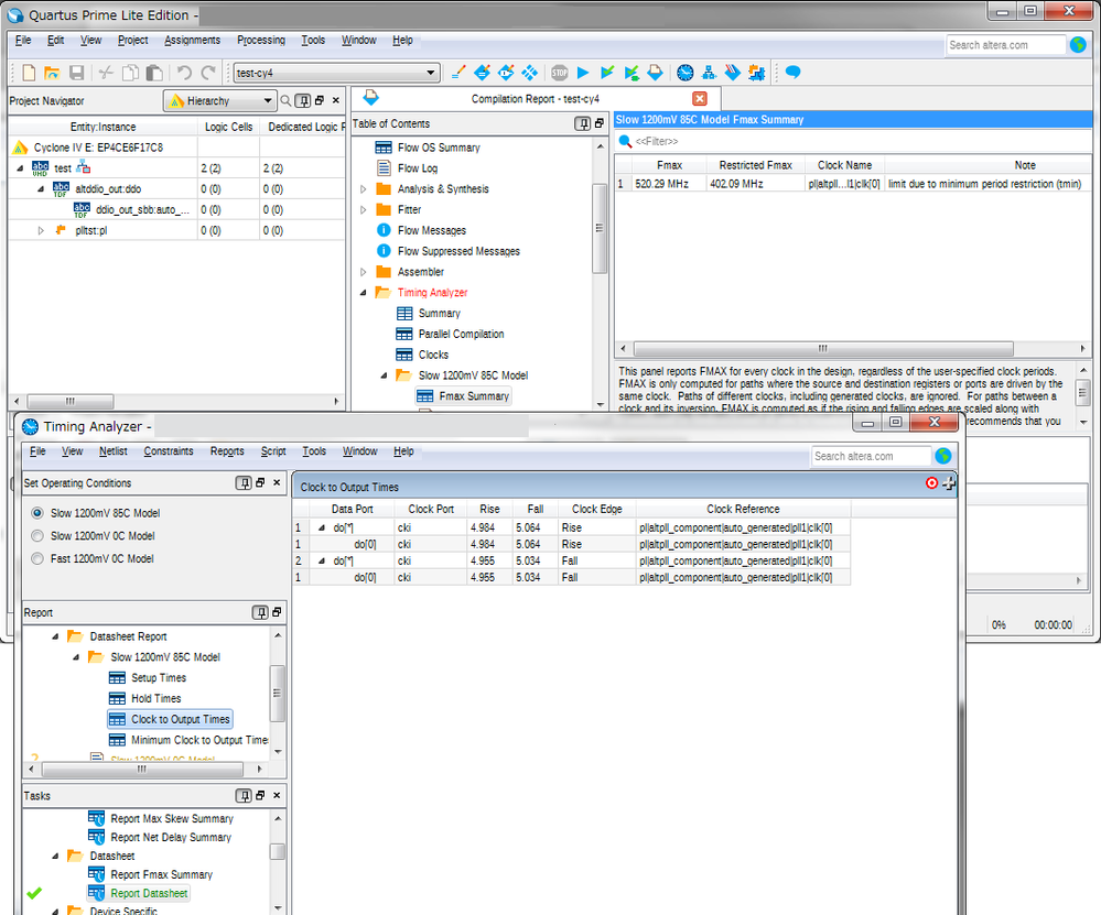

11 Replies
- KennyT_altera
Yes, your analysis is correct. This is also the reason why cyclone 10 E does not have emif to be instantiated. In your case, you will have to use cyclone 10 Gx and use phylite or altdq_dqs for it.
- TNaka61
Upload screen capture.
But I'm not sure if it's okay with this screen, so attach the project folder (except db, incremental_db).
The timing report for all cases is in the output_files folder of the attached file.
If there is no workaround, does it mean that cyclon10E can not be used instead of cyclon4E in this situation (like 300MHz x 2 time resolution)?
I'm very curious that cyclon10E's Tco is over 1ns faster under these conditions(2.5V,8mA,slew=2).
- KennyT_altera
I just recall somethings, can you go to timing analyzer and screenshot both delay out for comparison? I remember there are extra delay (like hmc delay stuff) and there is a workaround/avoid on this.
- KennyT_altera
If that is the case, then the comparison should be correct. As there are no better timing if those register that you have put inside the IO. Unless you use phylite or altdq_dqs2. Can you try to use AltDDIO to see if the result is different?
- TNaka61
ok, My result above is based on a register placed inside an I / O block
and The result of the above placement was examined in the resource property editor
- KennyT_altera
Yes, my question is does your result above is base on the register reside inside the I/O?
- TNaka61
>Can you check does your ddio and non ddio register is inside the IO?
I checked using the resource property editor on both devices.
This time it was necessary to specify "Fast output Register" explicitly on both devices
- KennyT_altera
https://www.intel.com/content/dam/www/programmable/us/en/pdfs/literature/ug/ug_altera_phylite.pdf
The IP core has a dedicated PHY clock tree in each I/O bank. The PHY clock tree is shorter which yields lower jitter and duty cycle distortion (DCD), enabling designs to achieve higher performance.
- KennyT_altera
Sometimes, quartus will not automatic put those register to the IO that would cause you to have a slower speed.
If the register is inside the IO, means your analysis is correct.
In arria 10, for speed that more than 200Mhz for DDIO. We would suggest customer to use phylite. But not for Cyclone 10LP.
- TNaka61
Thankyou for fast responce ... but,
I made a supplementary test with a FF in an IO pad that is non-DDIO.
so, I found that the speed was virtually the same as shown below.
DEVICE:10CL006YU256C8G (Cyclone 10 LP)
; Slow 1200mV 85C Model Fmax Summary ;
; Fmax ; Restricted Fmax ; Clock Name ; Note ;
; 656.17 MHz ; 402.09 MHz ; pl|altpll_component|auto_generated|pll1|clk[0] ; limit due to minimum period restriction (tmin) ;
DEVICE:EP4CE6F17C8 (Cyclone IV E)
; 656.6 MHz ; 402.09 MHz ; pl|altpll_component|auto_generated|pll1|clk[0] ; limit due to minimum period restriction (tmin) ;
From this result, it can be seen that only "Cyclone 10 LP"'s DDIO is about half the speed of non-DDIO,
and "Cyclone IV E"'s DDIO and non-DDIO are almost the same speed.
However, for both devices, the 0.5 cycle time is shorter than the Tco of DDIO output.
Therefore, the shortest pulse may disappear, but a long pulse should provide 0.5 cycle time resolution of the edge.
Is there a problem with my research method?
or Is either wrong?
