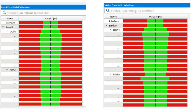

I'm facing at the traffic generator test failure (traffic_gen_fail = 1) after getting the calibration success (local_cal_success = 1).

  • With External Memory Interface Toolkit, the calibration report looks fine.
  • If DDR3 IP configured with Efficiency Monitor Interface, it shows 89.04%, the other reports look fine to me.
