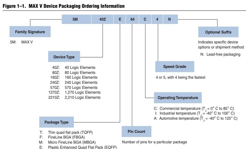

    Hello Long,
    Quartus can still program the -NAC suffix device. N means lead-free. AC is just internal id and no impact to the silicon inside.
    regards,
    Farabi

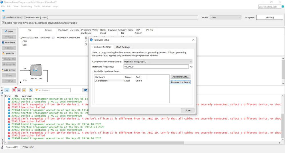

      Hi Farabi,
      Thank you for your advice.
      I tried with Quartus Prime Lite 20.1 to program this P/N: 5M570ZT100A5NAC. But not successful as below. (it is able to program 5M570ZT100A5N. So, could you please help to review and check ?
      Long.
  • Farabi_Altera's avatar
    Farabi_Altera
    Hello Long, I am checking with internal team. Please hold on.
    regards,
    Farabi
