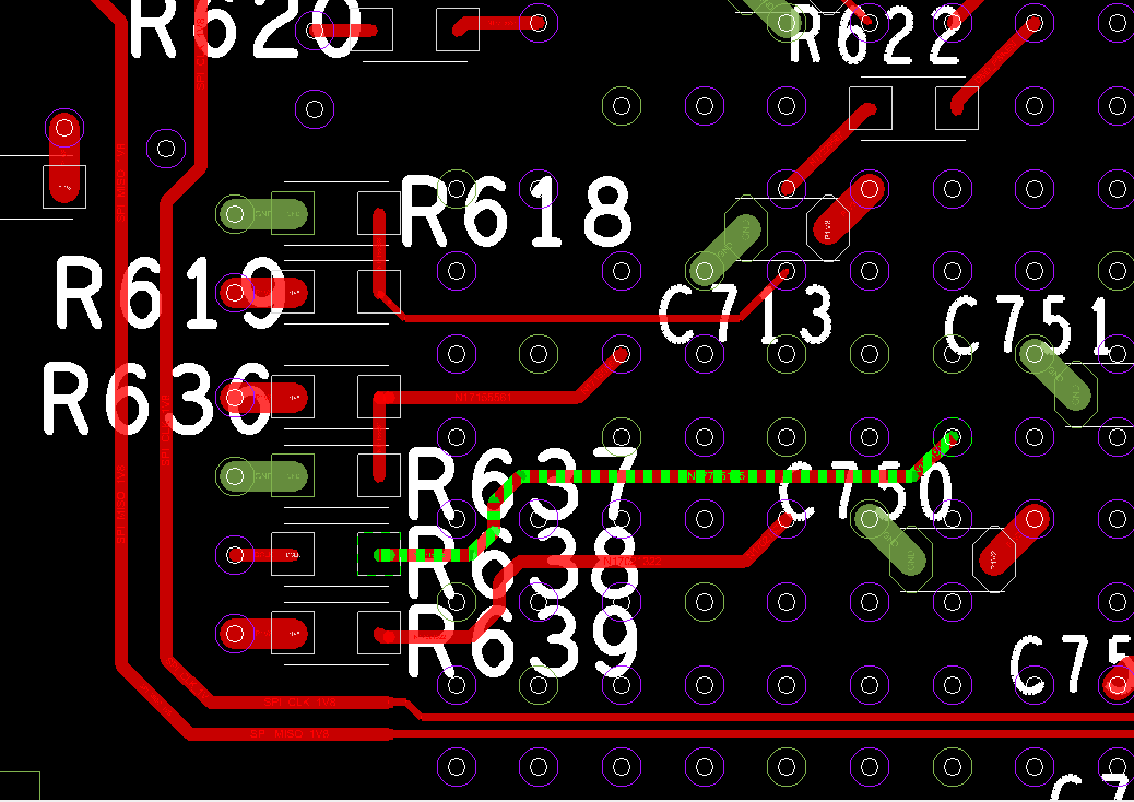

      It might be, but I have tried to eliminate the possibility. I have attached a screen grab of the layout. The purple vias are at the back of the Arria 10. R638 is the 22 ohm series termination resistor. I have tried removing R638 and installing a 1k ohm resistor from DCLK at the right pad of R638 to ground. I can still see the glitch with just 330 mils of trace.
      What is the source of the output clock on DCLK when programming a flash and trying to boot from one using Active serial? Is it the internal oscillator or is it dependent on CLK_USER? I also have other differential clocks input to IOs, but I don't think the flash loader design has any way of knowing they're clocks before configuration.
      If it matters, we're using the 10AX090N2F40E2SGJZ.

    May I know if there is a reason that you are using a buffer switch to connect the DCLK signal? I suspect that your U503 device is causing the glitches.
    If you look into Intel Arria 10 Development kit, we do not use any buffer or switches for the DLCK and just connect DCLK to both Passive Serial and Active Serial device directly. You may refer to https://www.intel.com/content/dam/altera-www/global/en_US/support/boards-kits/arria10/FPGA/A10GX_PCIE_E3p1.pdf.
