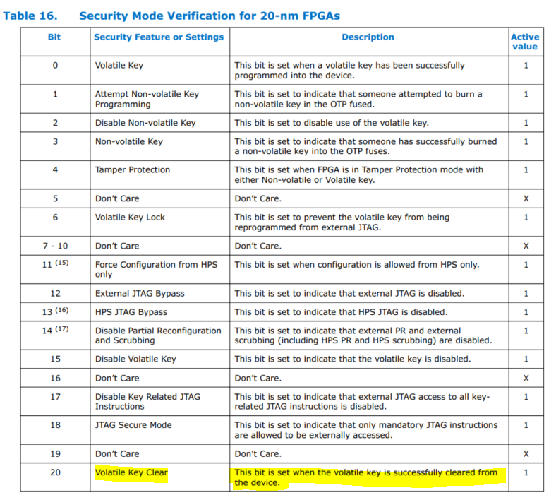

  • Hi,
    VCCBAT is a dedicated power supply for the volatile key storage. I believe the key will be gone if remove VCCBAT.
    If you do not use the volatile key, refer to the respective device family pin connection guidelines for VCCBAT connection.
    You can confirm if the volatile key is clear by perform the KEY_VERIFY JTAG instruction bit 20 to read out the information on the security features that are enabled on the chip. You can also verify by configure the FPGA without the key to ensure the volatile key is no longer needed. Refer figure on my next post.
