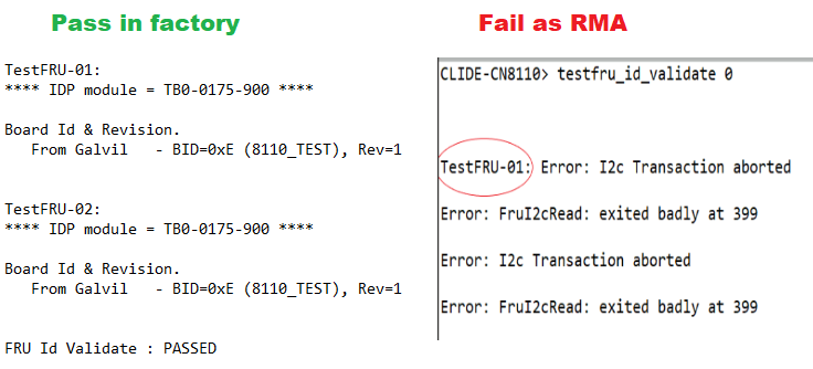

Customer reported: FRU1 Faulted. The unit booted up correctly, logs were retrieved The unit was vali Date Posted: November 27, 2023 Customer reported: FRU1 Faulted. The unit booted up correctly, logs were retrieved The unit was validated with Filler and TB0. FRU detection was validated, Slot 1 failed. Swap was done and the unit was validated again, failing same slot. FRU’s used during validation were M99441FD and M994C124, respectively before swap. Factory Reset was performed. Slot 1 remained failing. FRU0_SCL_SRC and FRU0_SDA were detected absent at Main Board. U91 was sent for replacement. Critical repair reported multiple damaged pads at removing BGA, and alerted the high risk of the repair process. This was escalated to Ciena, who authorized to continue with the repair. Pads of FRU0_SCL_SRC and FRU0_SDA signals were affected / damaged. This is a critical repair with its own risks. After repair, the unit was validated manually and still failed. The root cause of the field failure mode is damaged pads at U91 location. PN: EP4CGX110DF27I7N Qty: 2 Flex PN: N0230475

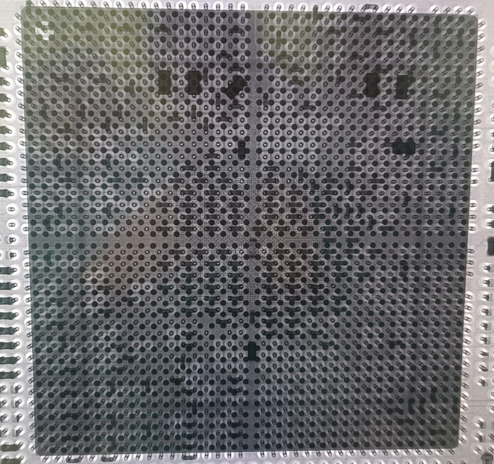

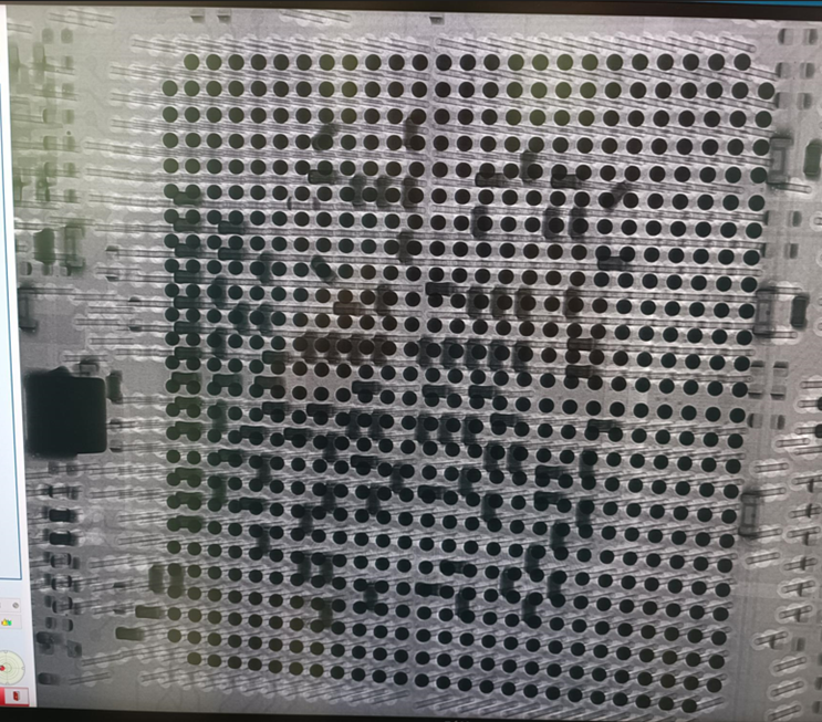

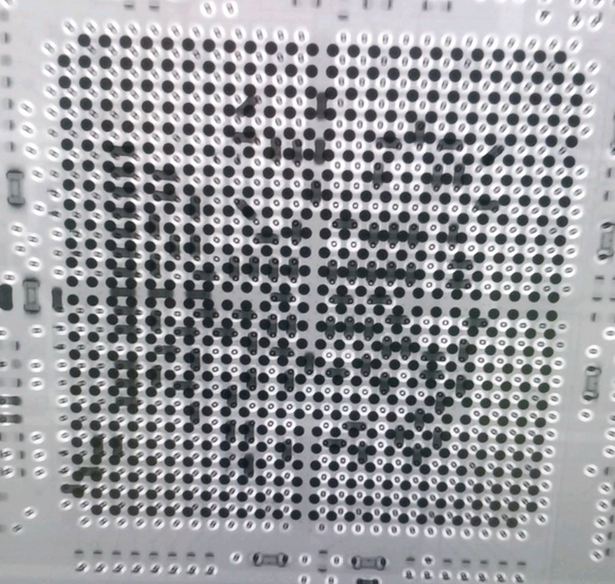

      Flex doesn't count with infrastructure to perform a Signal Tap. FPGA is bought to the broker Arrow and it arrives already programmed. Talking about mishandling, it is considered not likely due to test coverage: the unit passed all tests in factory, but failed in field. That's the why of 2nd level FA request.
      RX evidence attached.
      CAAAF2113E
      CAAAF2225E

      • Could you please explain what is the problem with your FPGA?
        Yes, FPGA was not sending signals to control one of the peripherals of the unit (there are two ones of this type, called P0 and P1). RMA unit could not communicate with P0 because of the absence of signals on AB8 and AF5 pins. Case was concluded as electrical damage.
      • is it power issue? config issue?
      No, it is not power issue, since all other functions related to FPGA were performed successfully. Only mentioned signals were not working properly. Do to this, I consider config issue unlikely, but component arrived programmed, there is no programming process in production floor to validate this part. Further analysis was required by Ciena due to the unit had failed in field, that is, it passed all test train in factory before shipping and failed with final customer.
      • what are the symptoms?
      Only symptom is the absence of mentioned signals, at pins AB8 and AF5, that should be working and they are not.
