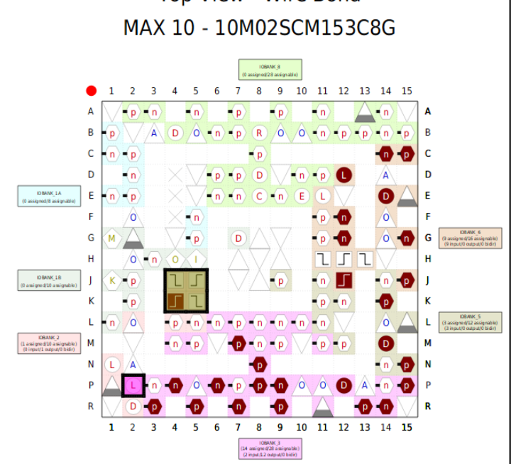

"Pins J4, J5, K4, and K5 can be used as PLL OUTPUTs.
Pin P2 can be used as a PLL INPUT."
No and no, it's the other way around.
As I mentioned, PIN_N1 is the other dedicated PLL output of 10M02SC153. If you are not obliged to achieve lowest jitter and skew, you can route PLL output to any IO pin and also use other dedicated clock inputs not directly routed to PLL1, e.g. CLK[2,3][p,n].
Regards Frank
- MartinMaa1 month ago
Hi Frank,

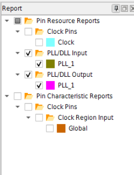

I’m a bit confused now. In the Pin Planner, when I select the PLL1 option in the report, what is the meaning of the pins enclosed by the bold black box? If they do not represent the input and output pins of PLL1, then what are they?After I select the checkbox, it specifically highlights these pins by enclosing them within a bold black box.
