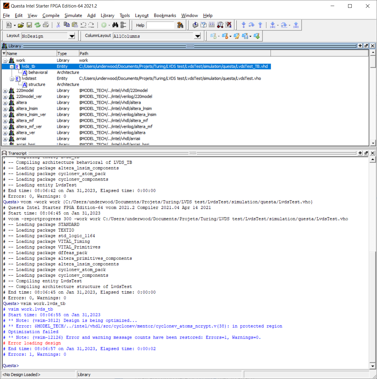

I'm running into simulation errors with a simple project instantiating a ALTLVDS_TX block on a cyclone V FPGA. Everything (admittedly not much) runs fine if I comment the block out... I also tried re-generating the IP with different ports / options, but didn't have any luck.
This is with Quartus 22.1 and questa 21.2.
I get the following error:
# vsim work.lvds_tb
# Start time: 09:49:13 on Jan 30,2023
# ** Note: (vsim-3812) Design is being optimized...
# ** Error: $MODEL_TECH/../intel/vhdl/src/cyclonev/mentor/cyclonev_atoms_ncrypt.v(38): in protected region
# Optimization failed
# ** Note: (vsim-12126) Error and warning message counts have been restored: Errors=1, Warnings=0.
# Error loading design
# End time: 09:49:15 on Jan 30,2023, Elapsed time: 0:00:02
# Errors: 1, Warnings: 0
Thanks for any help !

- sousbois
Hi Richard,
Thank you for your quick response. I wasn't able to find a .qar file in my project, but I uploaded my output directory.
I am not using Nativelink. I just started a questa work library and compiled my test bench along with the generated vho file from Quartus (attached).
I get the above error when I attempt to launch the test bench in Questa.
