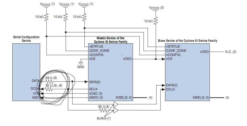

@Vic3Dexe wrote: I've cut traces and placed series resistors afters buffers (51R)
those resistors where are you connecting (data line or clk line or on both lines)
- if you see bellow attachment in schematic on clk and data lines using two different resistors in series.
