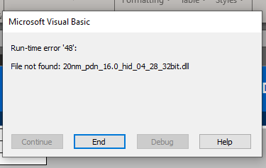

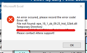

Is there any way to utilize the EPE / PDN with an O365 account? I keep getting this error when trying to do things with the EPE. And the PDN just doesn't change when I update variables

I'm trying to use PDN for Max10: https://www.intel.com/content/www/us/en/content-details/652727/power-delivery-network-pdn-tool-for-intel-max-10-devices.html
which is the file giving the error I screenshotted above... upon opening the file and when I trying to change the family.I also am trying to use the Max10 EPE: https://www.intel.com/content/www/us/en/content-details/652727/power-delivery-network-pdn-tool-for-intel-max-10-devices.html
which is giving me the same error
I can ignore the errors and try pressing buttons, but the buttons then have no effect. And when I try to manipulate values in the spreadsheet the report/calculations aren't appropriately updated.
