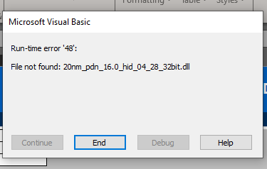

Can't use EPE or PDN with Office 365

Could you let us know what hardware or development tools that you are using?
Unfortunately based on the screenshot we are not able to understand the details
Hope to hear from you soon.

I'm trying to use PDN for Max10: https://www.intel.com/content/www/us/en/content-details/652727/power-delivery-network-pdn-tool-for-intel-max-10-devices.html
which is the file giving the error I screenshotted above... upon opening the file and when I trying to change the family.
I also am trying to use the Max10 EPE: https://www.intel.com/content/www/us/en/content-details/652727/power-delivery-network-pdn-tool-for-intel-max-10-devices.html
which is giving me the same error
I can ignore the errors and try pressing buttons, but the buttons then have no effect. And when I try to manipulate values in the spreadsheet the report/calculations aren't appropriately updated.

I do have have to enable editing after downloading the files, but the files don't actually seem corrupted/changed by my downloading them.
- jaxbir2672 years ago
I've tried Converting the workbook into Compatibility Mode which has worked for previous versions and the tools still don't respond to my inputs
