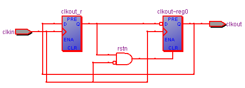

I'm always up for fun. It so happens I've never done this one before. How about this. It results in 2 ALUTs and 2 Registers.
Here's a shot from the RTL viewer:module div_by_3( input clkin, output reg clkout ); wire rstn; reg clkout_r; wire clkout_r_n; assign clkout_r_n = ~clkout_r; assign rstn = clkout_r_n | clkin; always @(posedge clkin or negedge rstn) if(~rstn) clkout <= 1'b0; else clkout <= clkout_r_n; always @(posedge clkin) clkout_r <= clkout; initial begin clkout = 1'b0; clkout_r = 1'b0; end endmodule - Altera_Forum
Honored Contributor
Cris72, are you compiling that in ModelSim or Quartus 2? Within Quartus 2 I'm getting the following:
Error (10239): Verilog HDL Always Construct error at asynchclockdiv.v(21): event control cannot test for both positive and negative edges of variable "clkin" line 21 is "always @ (posedge clkin or negedge clkin)" If you can trigger off both edges of the clock then the design of a div 3 is trivial. However, this isn't something you can easily do in Altera FPGAs. (at least that is my understanding). You are right though about the mark to space, I wasn't looking carefully enough at how your code worked. - Altera_Forum

--- Quote Start --- It's a representing a /6 rather than a /3 frequency divider. --- Quote End --- FvM, you are right. I wrote the code by heart and I forgot that I must clock registers on both pos and neg clock edges. Here is the 'real' working code; this time I also tested it with ModelSim
To Bat: I think the code is working and the mark to space is good, both in the initial /6 version and in the correct /3. Why not? If I remember correctly I already used this type circuit many years ago and it worked perfectly, with 50/50 duty cycle and no glitches. Regards Crismodule divider3 ( reset, clkin, clkout ); input reset; input clkin; output clkout; reg r1, r2, clkout; always @ (posedge clkin or negedge clkin) begin if (reset) begin r1 <= 1'b0; r2 <= 1'b0; clkout <= 1'b0; end else if (r1 & r2) begin r1 <= 1'b0; r2 <= 1'b0; clkout <= ~clkout; end else begin r1 <= 1'b1; r2 <= r1; end end endmodule - Altera_Forum
Honored Contributor
--- Quote Start --- am afraid Cris72 that your code doesn't appear to work. --- Quote End --- It's a representing a /6 rather than a /3 frequency divider. - Altera_Forum

I am afraid Cris72 that your code doesn't appear to work. I would also guess that the mark to space won't be that good either once corrected (though probably good enough for most people).
