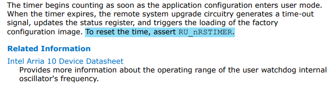

2- Why doesn't the watchdog trigger fallback when not served in the application image?
<ANS> From Remote Update IP document: watchdog timer only starts counting after FPGA enters usermode. If the application image is invalid- FPGA never reach usermode, watchdog is never activated. Watchdog must be explicitly enabled via RU_WATCHDOG_ENABLE in the factory image. If this is not done, the watchdog is by default- disabled.
In your setup:
1- You correctly enabled the watchdog in the factory image.
2- The application image does not serve the watchdog (no writes to RU_RESET_TIMER) which should trigger fallback only if the image enters user mode.
3- If the image is misaligned and fails to enter user mode, watchdog never starts-> fallback will never occurs.

Hello Farabi,
thanks for the reply. As mentioned before, if I enable the watchdog as described in your post, the fallback mechanism kicks in.
But this leaves me with 2 critical questions:
- When we do not use the watchdog (RU_WATCHDOC_ENABLE = 0). The factory fallback does not work when the application image is misaligned. Why does the factory fallback not happen in this case? I expect a misaligned application load to trigger a CRC error.
- Our application design is not actively serving the watchdog. We are using the Avalon IP "Remote Update Intel FPGA IP" Version 19.1.0. We do not set any of the Watchdog Registers in the application image, so I would have expected that the watchdog would trigger and cause a factory image fallback. But his is not happening. The documentation indicates, that a watchdog timeout may occur after entering application user mode. Hence I would expect that an application image, that does not service the watchdog would trigger a factory fallback. Why is this not the case?

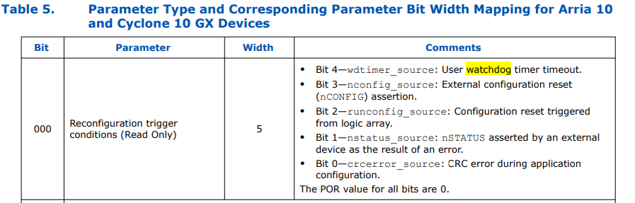

2- read RU_RECONFIG_TRIGGER_CONDITIONS to confirm power up state (Bit0 = 0)

4- read the RU_RECONFIG_TRIGGER_CONDITIONS reflecting the correct cause(Bit1 = watchdog timeout)
