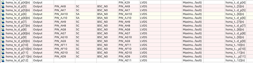

      It seems the fitting works when different banks are used. I checked the Stratix IV (which the complete synthesis is success) and the pin assigment has pins in different banks for same TX bus using LVDS. Please, check the screenshot. It uses 5C and 5A banks. Why in this case there is no clock tree complaining?
