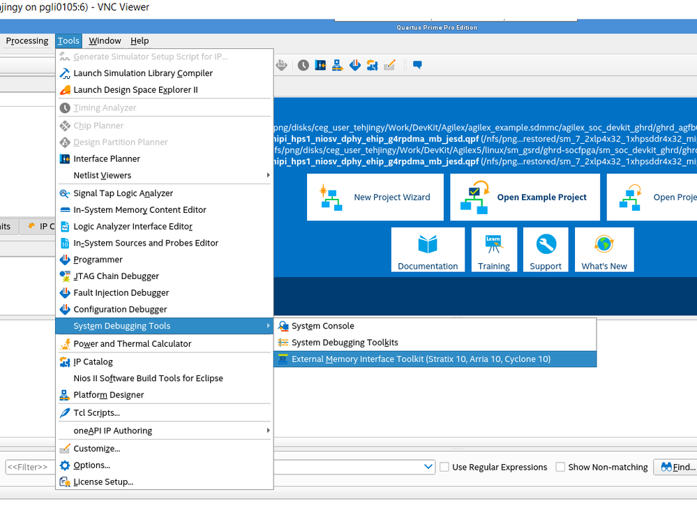

- tehjingy_Altera
Hi
There is an example for interfacing with DDR4 with the example below:
Jingyang, Teh
- nelky
hi Jingyang,
Thanks for coming back.
But can we use the Arria 10 or Cyclone V method on Agilex 7? Their architectures are different.

- tehjingy_Altera
Hi
You could luanch the emif debug toolkit from the quartus tool.
Seen below:
Jingyang, Teh

- tehjingy_Altera
Hi
Just updating the case for the SystemConsole launching the EMIF Tool kit
Please refer to the link on adding the EMIF toolkit to the project.
After adding it to the project you could launch using the method:
11.7.3. Launching the EMIF Debug Toolkit (intel.com)
Jingyang, Teh
