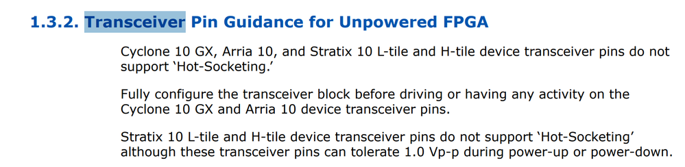

The A692 Power Sequencing Considerations app note states the below:
So it's clear for Cyclone GX, Arria 10, and Stratix 10 L/H tiles that no activity is allowed (with exception of 1.0 Vp-p on Stratix 10) on transceiver I/O during power-up but Agilex is not mentioned in this section.

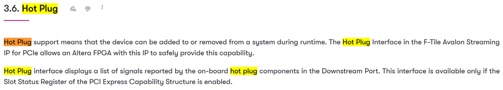

    Thank you for the link. Below image is what I see regarding hot plug. It states that the device supports addition/removal from system during run-time.
    I am not sure if this means Hot Plug is supported functionally but assumes the hardware design prevents I/O from being toggled while device is now powered by for example gating the I/O by having an enable for the REF_CLK buffer that is tied to the Agilex power supplies "Power Sequence Done" signal or similar.
    Can you please confirm Agilex7 F tile transceivers will not be damaged when Agilex 7 F tile hot plugged into system with like PCIe REF_CLK and PCIE data lines such that they are driven before the Agilex7 F tile is powered.
