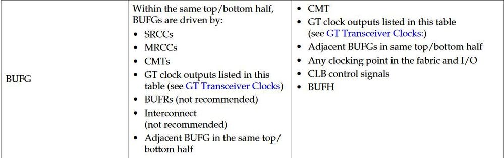

In xilinx FPGA, I see the BUFG specification for clock:
Does Intel FPGA has the BUFG specification too? Or what's the specification in Intel FPGA equivalent to BUFG, the GCLK or something else?

Xilinx said BUFG is Global Clock Buffer:https://support.xilinx.com/s/article/24983?language=en_US , so I ask if BUFG is GCLK in Intel FPGA. If yes, how many BUFGs in Arria 10 FPGA? Is it possible to see how many BUFG by using Quartus software?
