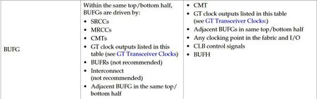

In xilinx FPGA, I see the BUFG specification for clock:
Does Intel FPGA has the BUFG specification too? Or what's the specification in Intel FPGA equivalent to BUFG, the GCLK or somet...
